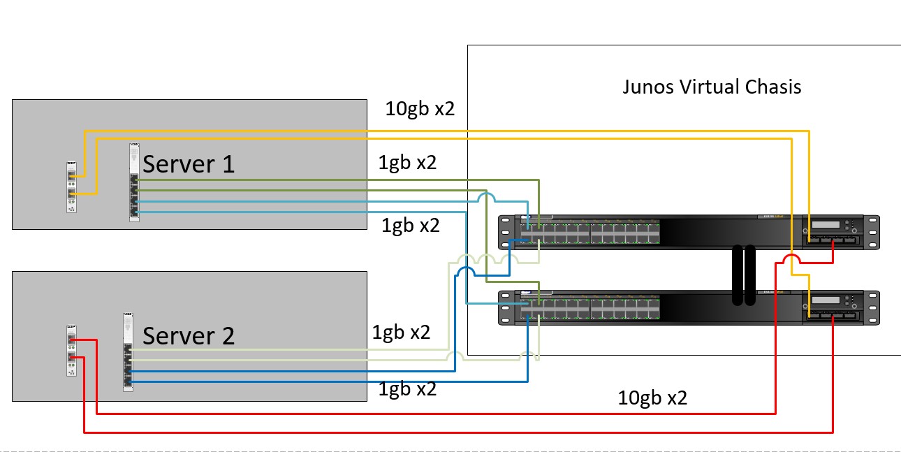

OK i will work on removing teaming from some of the interfaces.(will it work without breaking the teams??)
currently, there are 2 nics in the system a Quad 1gbe and a dual 10gbe
right now the way it is configured
with the juniper switches eliminating the single point of failure as the teamed nics are spanned across the 2 switches
Re: what am i doing wrong? VSan Free 2 node hpyer-v/ms cluster
Posted: Mon Jun 07, 2021 2:42 pm
by yaroslav (staff)
It will be supported without a team. Why not connecting the servers directly over 10 GBE?

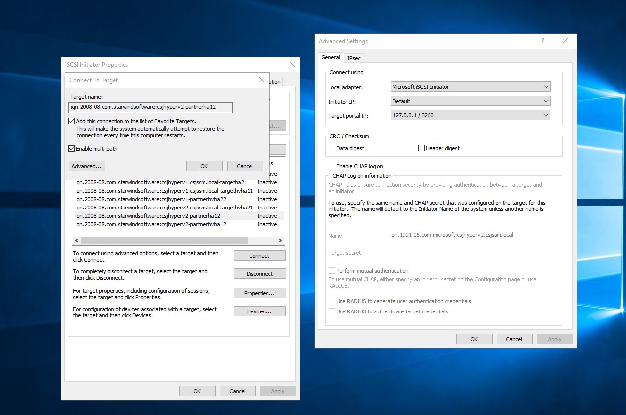

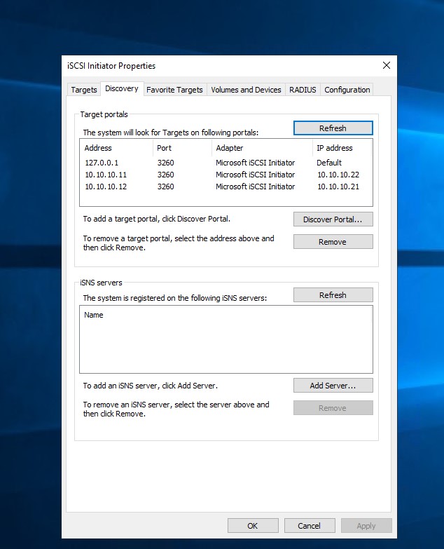

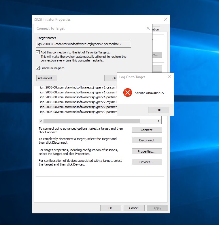

when i try to add the local iscsi targets on the 2nd host I get an error that the service is unavailable(there was no issue adding it to the 1st host
this is what I have in the discovery
this is the directions I am following
https://www.starwindsoftware.com/resour ... rver-2016/

Are HA devices synchronized?
Were you able to add both partner connections on the 1st server?
I noticed that you have 2 iSCSI interfaces in the same subnet. Please use different subnets. Also, do not reuse any of them for synchronization or VM connections.
You need to set <iScsiDiscoveryListInterfaces value=”0”/> to 1. Stop the service on one side -> go to StarWind.cfg -> copy the .cfg -> Make the change -> save it -> start the service -> wait for sync to be over -> repeat for the 2nd server.
