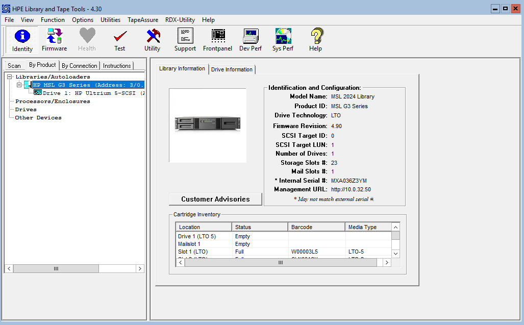

Nope, still offline. There's no AV for this machine and firewall won't be getting in the way (the tape drive is directly attached to the VSAN server via a fiber channel card). I've tried swapping out the fiber cable just in case, and the link comes up between the host and the tape drive but still no luck.
The drive and loader are definitely accessible on the VSAN server, I just installed the HPE Library and Tape tools to test it and I can see the library and drive and interact with them just fine. Is there anything else that could be preventing it from working?

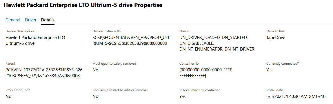

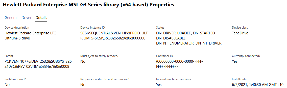

entr0p1
Posts: 13
Joined: Sun May 10, 2020 11:10 am
Sat Jun 05, 2021 10:35 am
yaroslav (staff) wrote:Is the disk visible in the disk management?
Tape drives don't show up in disk management, but they do show up in the Device Manager, if you check the two attached screenshots called "Drive" and "Library" you'll see it shows as currently connected. I can also use the tools for the library to communicate with it successfully (screenshot called "hp_tape_tools")
