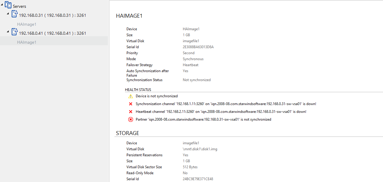

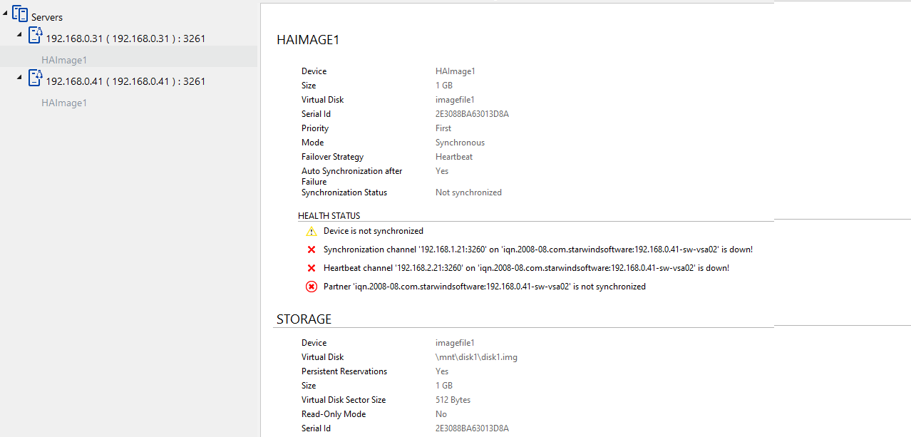

I obtain this message on VSA1:
- Synchronization channel '192.168.1.21:3260'on 'iqn.2008-08.com.starwindsoftware:192.168.0.41-sw-vsa02' is down
- Hwartbeat channel '192.168.2.21:3260'on 'iqn.2008-08.com.starwindsoftware:192.168.0.41-sw-vsa02' is down
- Partner '192.168.1.21:3260'on 'iqn.2008-08.com.starwindsoftware:192.168.0.41-sw-vsa02' is not synchronized
and this in VSA2:
- Synchronization channel '192.168.1.11:3260'on 'iqn.2008-08.com.starwindsoftware:192.168.0.31-sw-vsa01' is down
- Hwartbeat channel '192.168.2.11:3260'on 'iqn.2008-08.com.starwindsoftware:192.168.0.31-sw-vsa01' is down
- Partner '192.168.1.11:3260'on 'iqn.2008-08.com.starwindsoftware:192.168.0.31-sw-vsa01' is not synchronized
Connecting with putty to VSA1 I can ping 192.168.0.41, 192.168.1.21 and 192.168.2.21
Connecting with putty to VSA2 I can ping 192.168.0.31, 192.168.1.11 and 192.168.2.11

Here some screenshot
