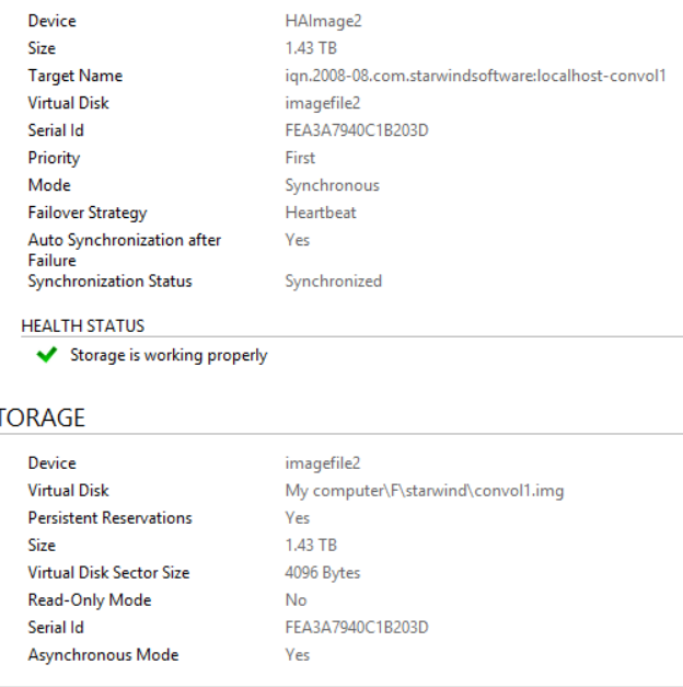

i have a new HA cluster with 2 hyper-v hosts with 3 disks
1 whitness 100MB
1 VOL1 1,5TB
1 VOL2 1,5TB
nic's are direct attached as folows
SYNC HOST1 10gbit nic direct attached to 10gbit nic host 2 (no redundancy, yet)
host 1 sync ip 10.0.100.10
host 2 sync ip 10.0.100.20
HB HOST1 10gbit nic direct attached to 10gbit nic host 2 (no redundancy, yet)
host 1 sync ip 10.0.101.10
host 2 sync ip 10.0.101.20

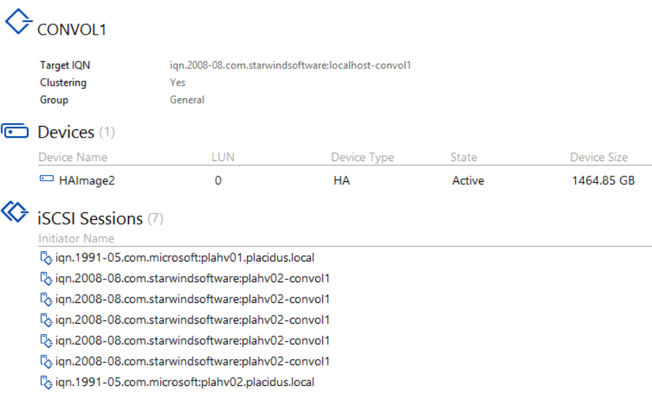

all iscsi targets are HA iscsi attached with 2 MPIO connection (exept for the whitness which is only locally connected). All of the VM's were registered on the host i would NOT reboot.
the problem is when i reboot 1 of the 2 hosts the storage goes completly offline, so there is no failover. i don't know of this is normal. It was also a "clean" reboot so the hosts could have negotiated.

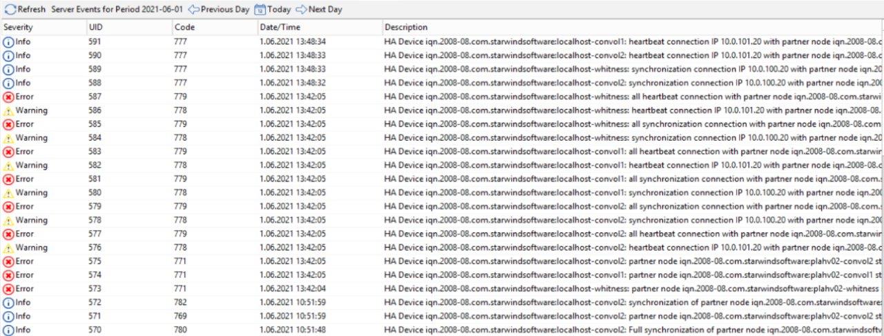

attatches you find a few screenshots of my setup and the events of the host which remained online (so not the host i rebooted) and the storage went offline.
the storage came back up pritty quickly after the reboot, but this is not HA as it should be offcourse.

Did the log check. The problem was that you did not let sync to finish prior to restart. 01 was still doing sync when 02 was restarted. See the restart procedure here https://knowledgebase.starwindsoftware. ... installed/.
If the problem repeats even with devices synchronized on both sides, send an email to us support@starwind.com
