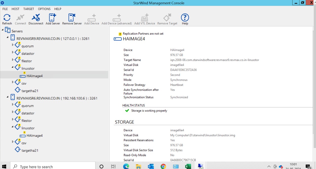

Hi, the affected config file has all devices there on the affected .cfg. Would you be so kind to provide the screenshot from the Management Console?
harish.patil
Posts: 23
Joined: Sun Oct 27, 2019 8:31 am
Thu May 20, 2021 7:09 pm
Please find attached screenshot of the console.
Posts: 4510
Fri May 21, 2021 12:53 pm
You need to remove the replica to the affected server (run RemoveHAPartner.ps1 from C:\Program Files\StarWind Software\StarWind\StarWindX\Samples\powershell), remove the HAs on the affected server from the underlying storage and recreate the replica with AddHAPartner.ps1.

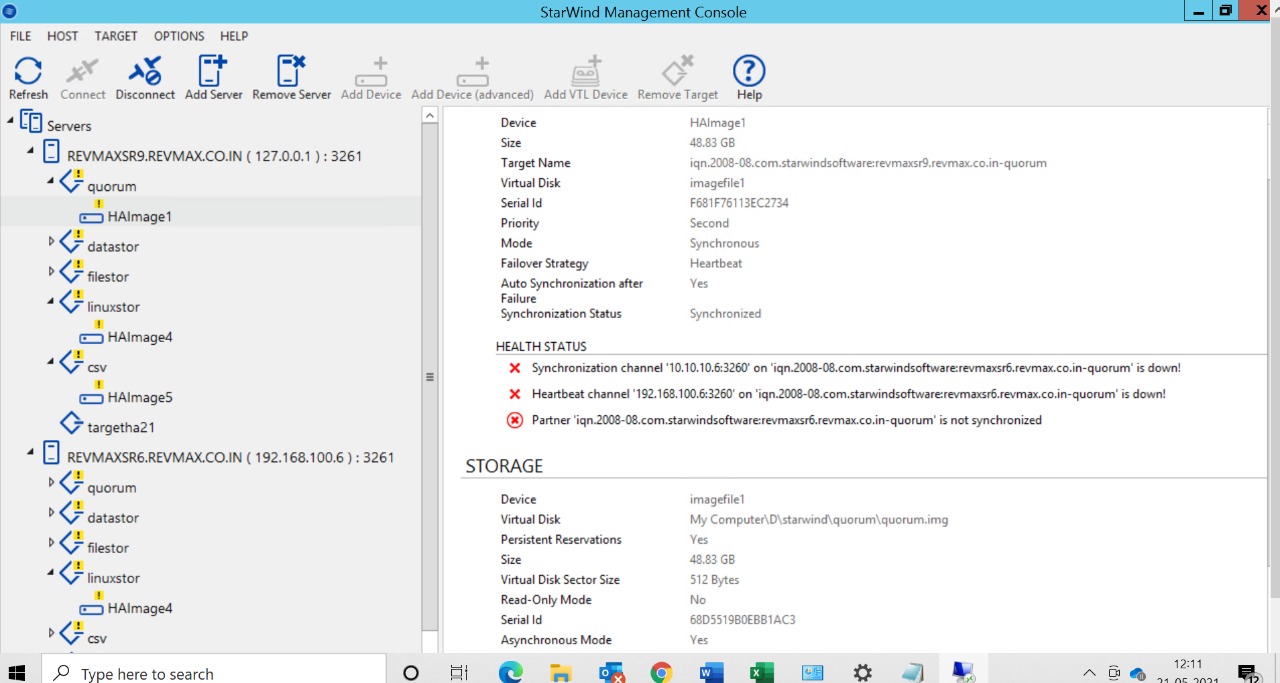

The above code is giving me below error
PS C:\Users\administrator.REVMAX\Desktop> C:\Users\administrator.REVMAX\Desktop\AddHaPartner.ps1
Exception calling "AddPartner" with "1" argument(s): "Request to REVMAXSR9.REVMAX.CO.IN ( 192.168.100.9 ) : 3261
control 0x000000FD39878A00 -AddPartner:"" -PartnerTargetName:"#p1=iqn.2008-08.com.starwindsoftware:revmaxsr6.revmax.co.in-linuxstor" -Priority:"#p1=2" -nodeType:"#p1=1" -
PartnerIP:"#p1=REVMAXSR6.REVMAX.CO.IN:1" -AuthChapType:"#p1=none" -AuthChapLogin:"#p1=0b" -AuthChapPassword:"#p1=0b" -AuthMChapName:"#p1=0b" -AuthMChapSecret:"#p1=0b" -Re
plicator:"#p1=0"
200 Failed: invalid partner info.. "
Also attaching screenshot of affected node console
Posts: 4510
Sat May 22, 2021 9:03 am
Did you remove the replication partners from the underlying and StarWind Console prior to adding the replicas?
