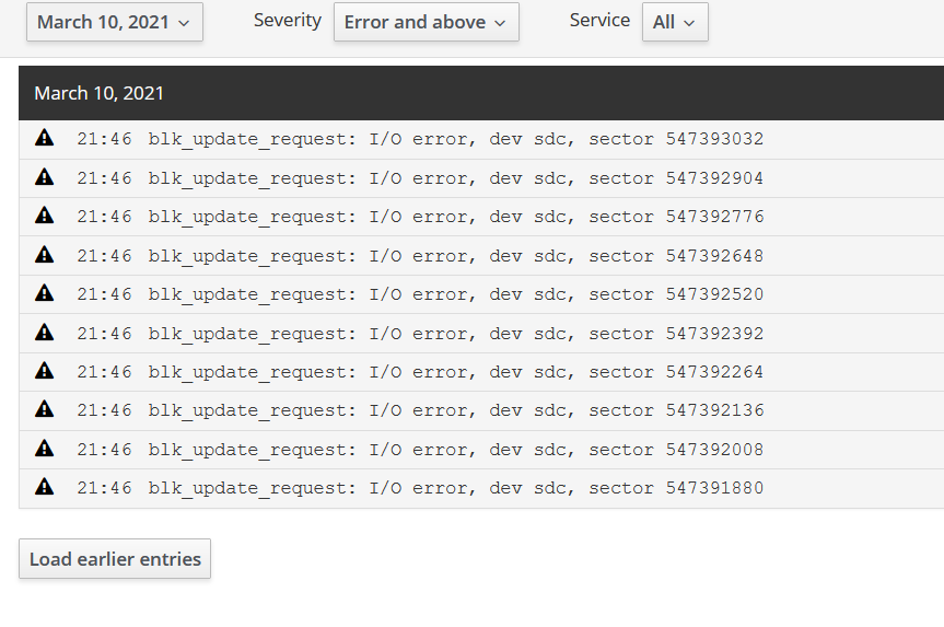

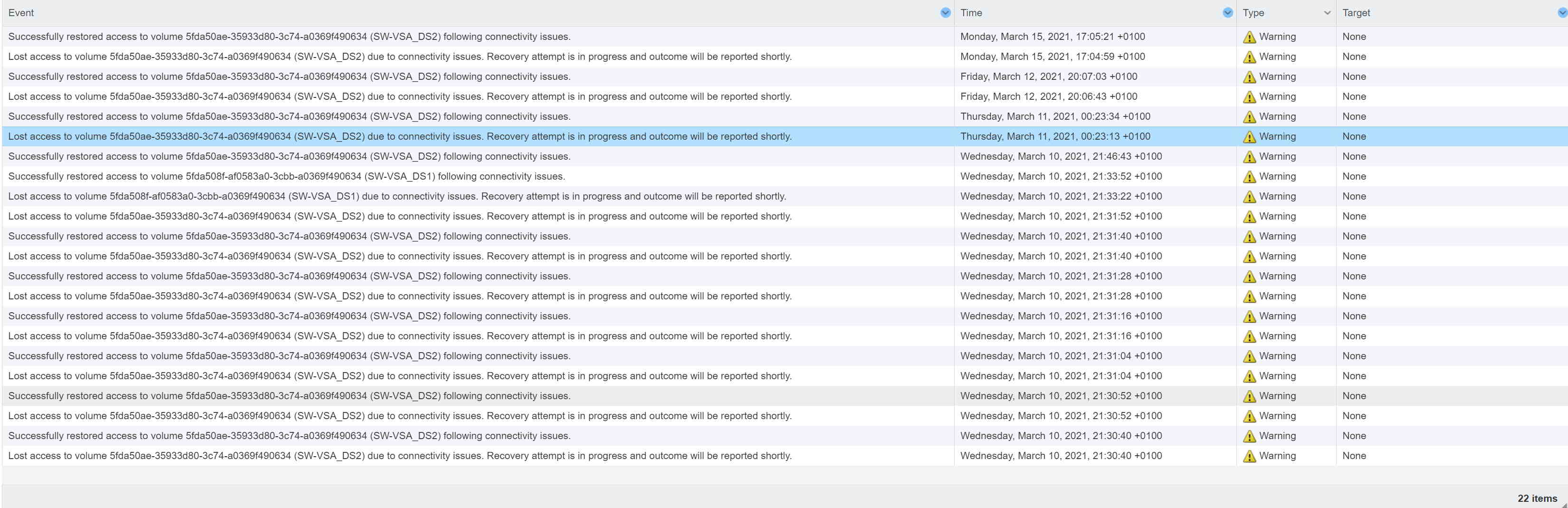

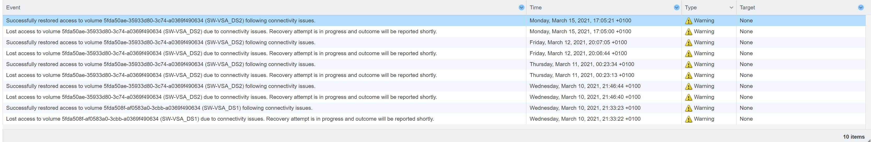

I've noticed that one HA image in our 2-node hyperconverged cluster fell out of sync (which is interesting, because the other remaining HA image was ok) and stayed unsynced until I've manually triggered a sync. After that, a full synhronization started.
Which logs should I investigate if we use Linux VSAN appliances? Any idea about what could be going on?

I was not able to find any events on 01 log about the partner going out of sync.
NODE1
3/15 20:04:53.987656 182 HA: HASyncNode::fixTypeForSync: Synchronization method HA_SYNCH_TYPE_FAST will be changed to HA_SYNC_TYPE_FULL because storage IO errors were detected.
here is 01 changing its status to Synchronizing
3/15 20:04:53.994867 8b HA: HANode::setSyncStatus: Event: Device changed own sync status to 2 from 3. (target 'iqn.2008-08.com.starwindsoftware:10.20.10.22-ds2')
Note that sync was running only for DS2.
Also, there are no logs older than Mar 12, while another node contains older logs. Logs on 01 are flooded with 3/12 9:53:56.127478 f3 Tgt: *** iScsiTarget::openSession: iqn.2008-08.com.starwindsoftware:10.20.10.22-ds2: can't register session. The device 'HAImage2' is not ready.
3/12 9:53:56.127489 f3 T[15369,1]: ***iScsiTask::startLoginPhase: *ERROR* Login request: device open failed.
3/12 9:53:56.127608 18b C[15369], IN_LOGIN: iScsiConnection::doTransition: Event - LOGIN_REJECT.
3/12 9:53:56.378476 f3 C[15369], IN_LOGIN: iScsiConnection::recvData: Recv - peer shutdown
3/12 9:53:56.378529 f3 C[15369], IN_LOGIN: iScsiConnection::receive: recvData returned error 10058 (0x274a)!
3/12 9:53:56.379032 a8 S[15369]: iScsiSession::~iScsiSession: ~Session
3/12 9:53:58.068781 9 Srv: iScsiServer::listenConnections: Accepted iSCSI connection from 172.16.10.20:14920 to 172.16.10.22:3260. (Id = 0x1536a)
3/12 9:53:58.068839 9 S[1536a]: iScsiSession::iScsiSession: Session (00007FE23B1D1700)
3/12 9:53:58.068851 9 C[1536a], FREE: iScsiConnection::doTransition: Event - CONNECTED.
3/12 9:53:58.319782 1f2 C[1536a], XPT_UP: iScsiConnection::handleFirstLogin: Login request: ISID 0x00023d000001, TSIH 0x0000.
3/12 9:53:58.319868 1f2 C[1536a], XPT_UP: iScsiConnection::doTransition: Event - LOGIN.
3/12 9:53:58.319926 1f2 Params: iScsiParameter::update: <<< String param 'InitiatorName': received 'iqn.1998-01.com.vmware:wit-a-esx1-4a77acb3', accepted 'iqn.1998-01.com.vmware:wit-a-esx1-4a77acb3'
3/12 9:53:58.319953 1f2 Params: iScsiParameter::update: <<< String param 'TargetName': received 'iqn.2008-08.com.starwindsoftware:10.20.10.22-ds2', accepted 'iqn.2008-08.com.starwindsoftware:10.20.10.22-ds2'
3/12 9:53:58.319967 1f2 Params: iScsiParameter::update: <<< Enum param 'SessionType': received 'Normal', accepted 'Normal'
3/12 9:53:58.320001 1f2 Params: iScsiParameter::update: <<< Enum param 'AuthMethod': received 'CHAP,None', accepted 'CHAP'
3/12 9:53:58.324800 1f2 HA: HASyncNode::registerSession: Client initiator iqn.1998-01.com.vmware:wit-a-esx1-4a77acb3 is trying to register a session within the 'iqn.2008-08.com.starwindsoftware:10.20.10.22-ds2' target... (sessId = 0x1536a, initiatorNameIsid = iqn.1998-01.com.vmware:wit-a-esx1-4a77acb3,00023D000001)
3/12 9:53:58.324821 1f2 HA: HASyncNode::registerSession: Unable to register the new client session. The node is not active!
3/12 9:53:58.324832 1f2 HA: HASyncNode::registerSession: Return code 21.
This means that DS2 on 10.20.10.22 was not synchronized quite a while ago. DS1 was in sync though.
Based on the logs from Node2, DS2 went out of sync last time on MAR 10.
Line 3483: 3/10 21:33:23.193383 bd HA: CHAPartnerNode::SetSyncStatus: Event: Partner device changed sync status to 3 from 1. (partner: 'iqn.2008-08.com.starwindsoftware:10.20.10.22-ds1')
Line 3536: 3/10 21:46:33.881135 78 HA: CHAPartnerNode::SetSyncStatus: Event: Partner device changed sync status to 3 from 1. (partner: 'iqn.2008-08.com.starwindsoftware:10.20.10.22-ds2')
DS1 went back to sync, while DS2 did not.
HA devices went out of sync due to timeouts.
3/10 21:30:07.622371 40 HA: Ssc_Request_Task::complete: Warning(Partner send): sscRequestTask(0x0000000043851270) partnerRequest(0x0000000043C72010) GeneralFunction(Execute SCSI Command) GeneralOpCode(0x2A) ex(0x0), PartnerOpCode(0xF2), PartnerDiffTimeCompleteEXEC = 6452, ms DiffTimeCompleteINIT = 6452 ms, DiffTimeCompleteEXEC = 6452 ms. Current target: 'iqn.2008-08.com.starwindsoftware:10.20.10.23-ds1', Partner traget: 'iqn.2008-08.com.starwindsoftware:10.20.10.22-ds1'!
3/10 21:33:23.167077 40 Common: *** iscsi_tcp_dispatch: request execution timed out (9999 ms) for target iqn.2008-08.com.starwindsoftware:10.20.10.22-ds1.
and
3/10 21:33:23.205687 a3 HA: Ssc_Request_Task::complete: Warning: sscRequestTask(0x0000000043C7A370) Funciton(Execute SCSI Command) OpCode(0x89) ex(0x0) DiffTimeCompleteINIT = 10049 ms, DiffTimeCompleteEXEC = 0 ms. Target: 'iqn.2008-08.com.starwindsoftware:10.20.10.23-ds1'
3/10 21:33:23.207897 b8 HA: Ssc_Request_Task::complete: Warning: sscRequestTask(0x000000004486A7E0) Funciton(Execute SCSI Command) OpCode(0x89) ex(0x0) DiffTimeCompleteINIT = 9966 ms, DiffTimeCompleteEXEC = 0 ms. Target: 'iqn.2008-08.com.starwindsoftware:10.20.10.23-ds1'
3/10 21:33:23.208585 b9 T[1c,df50af]: iScsiTask::handleTaskMgmtCmd: Management command: abort task (CmdSN 14635137, ITT 0x9950df00) not found.
3/10 21:33:23.209503 40 HA: Ssc_Request_Task::complete: Warning(Partner send): sscRequestTask(0x000000004370E6E0) partnerRequest(0x0000000043C64FE0) GeneralFunction(Execute SCSI Command) GeneralOpCode(0x2A) ex(0x0), PartnerOpCode(0xF2), PartnerDiffTimeCompleteEXEC = 9995, ms DiffTimeCompleteINIT = 9996 ms, DiffTimeCompleteEXEC = 9996 ms. Current target: 'iqn.2008-08.com.starwindsoftware:10.20.10.23-ds1', Partner traget: 'iqn.2008-08.com.starwindsoftware:10.20.10.22-ds1'!
Please check the underlying storage health.
