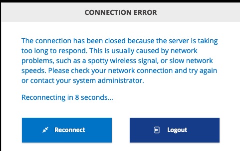

StarWind Managment console installed on a dedicated Windows server 2016 VM with default config. License is applied and I can connect / configure virtual SA
StarWind Web Appliance deployed on the same host/vSwitch but after updating connection settings it still fails to connect due to timeout.
I don't see anything in the log on Managment console side and I was not able to login into shell on Web appliance, what is default user/password for accessing shell ?

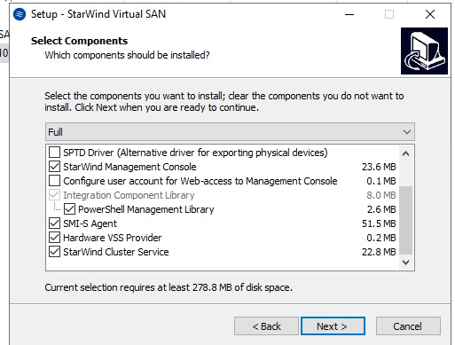

Welcome to StarWind forum. Here is the technical paper https://www.starwindsoftware.com/resour ... r-vsphere/ on how to set up Linux-based edition of StarWind VSAN. While installing StarWind Management Console, please install the PowerShell Management Library (there should be an option in StarWind VSAN installation wizard) to be able to manage your Linux environment with PowerShell. Please use the IP of StarWind VSAN VM in scripts instead of 127.0.0.1 to run them.
On Windows box, While installing Management Console, you need to select ONLY StarWind Management Console and PowerShell Management Library.

With respect to client, the last step (connecting to server) fails with timeout.
I.E I can deploy VM, connect to GUI, change password / server IP address, but afterwards connection fails.
SW-connect error.jpg (49.73 KiB) Viewed 20235 times
