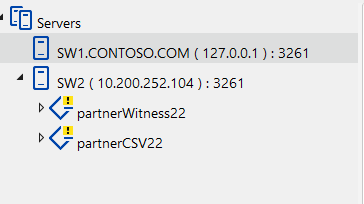

Hello Yaroslav.
I have made my experiment on hyper-v virtual machines. Each virtual machine has two disks, one for system and another for starwind data.
I have installed and configured StarWind vSan free and then scale-out two node file server.
Then I have deleted data disk from one of nodes. The file cluster continued works perfectly! StarWind Software is really cool!
Then I have created a new vhdx disk and atthached it instead of "lost" disk.
The screenshot from StarWind console in attached file:
Should I delete devices and targets by powershell before running a script that you suggested me?

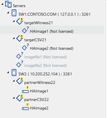

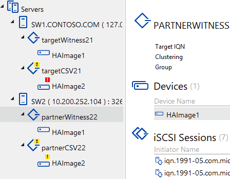

Mon Sep 14, 2020 6:52 am
Hello Yaroslav.
I have made steps according your messaged and have following results:
After deletion devices and targets on "failed node":

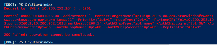

Results of running script:
Posts: 4509
Mon Sep 14, 2020 7:31 am
Can I have the script here please?
jdeshin
Posts: 63
Joined: Tue Sep 08, 2020 11:34 am
Mon Sep 14, 2020 8:07 am
The script in attachment
AddHaPartner.zip
