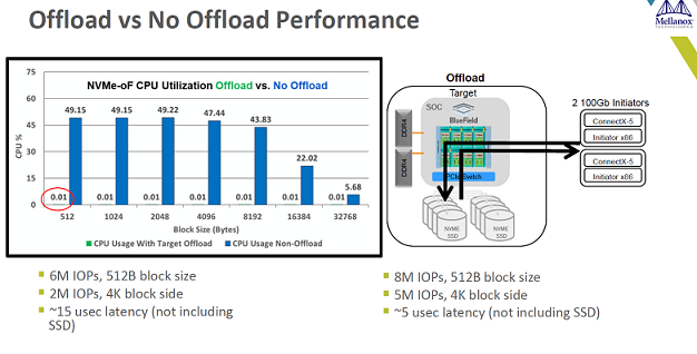

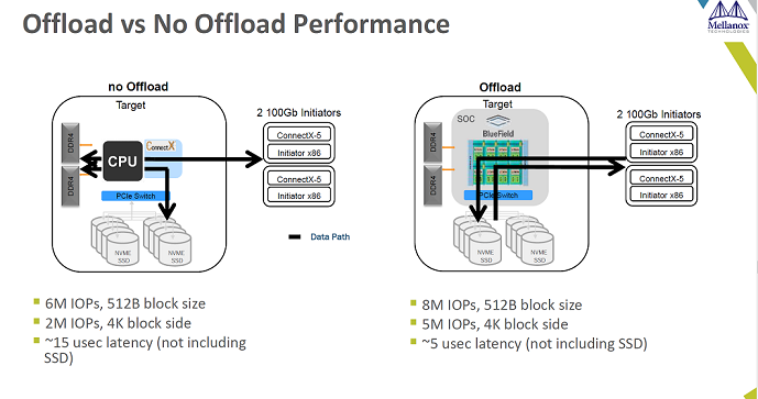

I know that nvme-of works over rdma, my question was specifically if your target driver would take advantage of a nic that does nvme-of offloads, because of the impact it has on performance an cpu usage.
In the attached images from Mellanox its clear the advantages of ofloading, cpu usage is almost 0 and you get 0% 2.5x performance on 4K block size .
Mellanox nvme-of3.png (92.05 KiB) Viewed 29578 times
Mellanox nvme-of4.png (97.17 KiB) Viewed 29578 times
