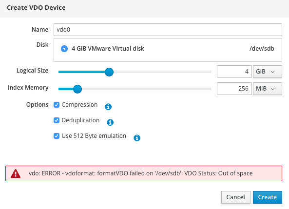

How to add a device to VDO? An error is reported when adding it. Do you have this document

The two options selected by you are optional, while the bottom one is mandatory ("Use 512 Byte emulation" - not selected in your case). Enable it and try the same action.

I follow your instructions or the same error prompt. No matter how to select the option, I cannot create a VDO device

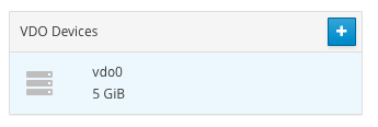

You will not be able to create a VDO device on top of a disk smaller than 5GB. See screenshots from my lab:
This looks to be a limitation from RedHat, although I was not able to find anything like that in their VDO documentation.

create vdo IS OK! THANKS!
