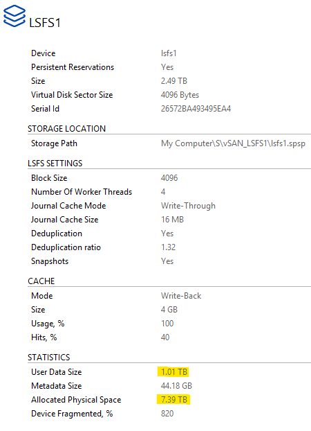

I have been using Starwind vSAN free v8.0.13182 for the last few months. I am very impressed by the speed of drive, and once I learned the correct powershell commands, administering it was fine as well.
I have used the advice here and setup a ReFS mirrored array, then a deduped LSFS device on top of that. I have adequate RAM, and I have created my LSFS device based on 200% over-provisioning.
Attached is a screenshot of the LSFS device showing just over 1TB of user data, that it is taking up 7.5TB of physical disk space. Is this expected behaviour? Is there some sort of manual garbage collection that I am meant to be running?
LSFS Device
LSFS Device
Annotation 2019-12-02 105229.png (26.96 KiB) Viewed 89427 times
How do I keep this disk usage under control?
Daniel

As troubleshooting, I flushed the cache and then restarted the Starwind service (in a hope that it would force try defragging that device) and after 6 hours the device is now remounted, but with the same size and amount of fragmentation (820%).

Hi Boris,
My underlying storage is 7.48 TB in capacity, and the LSFS device is one-third of that at 2.49 TB, so I have left 200% additional capacity on the underlying storage.
The concern is that at the moment the LSFS device only contains 1.01 TB of data, yet is consuming 7.39 TB of storage; by those numbers I would have to be over-provisioned by more than 600%! From what I can see there has been none of the automatic defragmentation that is mentioned in the https://knowledgebase.starwindsoftware. ... scription/ page:
How Defragmentation works:
Defragmentation works continuously in the background. Each file segment will be defragmented when data capacity exceeds the allowed value. Maximum allowed junk rate before defragmentation process is initiated equals 60%. This value can be changed using the context menu of the device.
Data from the old fragmented file segment will be moved to another empty file segment and the old file will be deleted.
If the available disk space on the physical storage is low, the LSFS uses more aggressive defragmentation policy and slows down access speed for the end user. If there is no space on the physical drive, LSFS enters the “read-only” mode.
My user data has stayed pretty consistent over the last 2 months (hovering around 1 TB), but the "Allocated Physical Space" has been growing until it filled the underlying storage and the "Device Framentated, %" has stayed very high (currently at 820%).
I can copy the data off the read-only LSFS device and recreate the LSFS device, but if it keeps growing (the LSFS device, not the user data contained within), then in another two months I will be in the same predicament, and recreating the the LSFS device every two months isn't a sustainable practice.
Daniel

I have gone through the process of migrating my LSFS device to a much larger storage array (15 TB). After remounting the LSFS device I am still seeing very large amount of fragmentation (820%) - I haven't received an answer yet whether this is the expected behaviour?
I am excited by the performance of the LSFS device, and am willing to sacrifice a ratio of 1:3 data to storage space to utilise it, but I am seeing continual growth beyond 3x the size of LSFS device.

An update for the community here.
The issue with too much storage consumption was preconditioned by disabled automatic defragmentation option at the time of the device creation.
If anybody happens to stumble upon that here is an instruction on how to overcome this:
1. Stop the StarWind service to enable device header editing. Unfortunately, it cannot be edited on the fly.
2. Locate the *.swdsk file in the device folder and make a backup of the file prior to any further operations. Open the original one with some text editor (Notepad++ is ideal for this purpose).
3. Find the line:
<AutoDefrag>no</AutoDefrag>
and change its value to "yes"
<AutoDefrag>yes</AutoDefrag>
4. Save the file.
5. Start the StarWind service. After the service is started, open the above header file again and check the value of that parameter (should stay "yes" if everything is done properly).
As reported by the user, storage usage went down from 10TB to 1.1TB, and fragmentation ration went down from 1100% to 26%.
