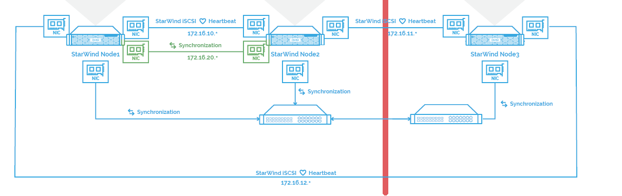

I have adapted a schema to illustrate the situation. Red line represents the gap between rack rooms, which are connected with said 3 fiber lines. Example has iSCSI as direct connections, and sync via switch, but it could be vice versa.
Also green part is redundant or does it provide any benefit?
Limited network 3-node proposal. Image adapted from Resource Library, hope You don't mind.

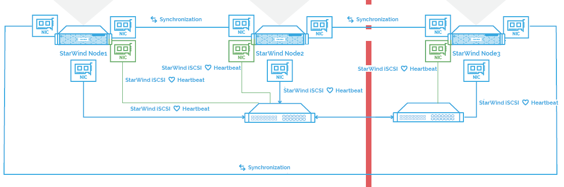

StarWind recommends using a direct connection for Synchronization and iSCSI channels, but it is also possible to use switches for these types of traffic. Considering that you are short on NICs, you could connect Synchronization channels directly, letting iSCSI/Heartbeat go through 2 switches.
Here’s the recommended schema that should fit your case (the drawing is retrieved from our StarWind VSAN best practices: https://www.starwindsoftware.com/best-p ... practices/).
Here is the setup configuration we recommend
what we recommend.png (71.96 KiB) Viewed 8298 times

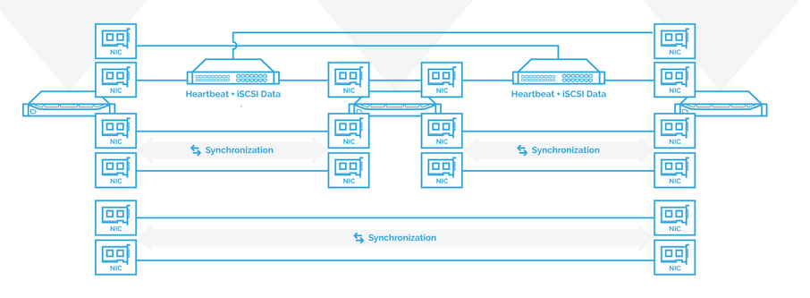

Dual Synchronization interfaces in your scheme are there for redundancy. Since you are short on NICs, leave only 2 channels for synchronization on each node; here’s how exactly you can design the environment.
And here is how you can build the environment
How you could build the environment.png (34.21 KiB) Viewed 8298 times
Such a configuration is pretty risky as you do not have a connection between Node1 and Node3. Sync NICs and links between them are the single point of failure. And, unfortunately, your HPE servers do not allow for adding 2x fiber channel NICs for Synchronization traffic, meaning that you need to use 1 dual-port NIC. Keep in mind that this setup is very unreliable.
If one of your switches goes down, your cluster remains operational because only iSCSI flows through them. Some disks, in turn, remain available to the cluster as they are connected over the local loopback sessions. The cluster remains operational only in case of being configured as the 3node replica; being configured as grid, devices are not connected over the loopback iSCSI sessions. Keep in mind that you also should have redundant management connections to both switches.

I see, so the sync link is more important to be connected directly, than iscsi/heartbeat links.
As I stated, we also can use the regular 1G NIC for additional heartbeat. Or is this unnecessary/pointless?
Now I understand, that a better approach would be placing all 3 nodes on same rack and manage the "off-site" backups independently.

Yes, Sync should go directly. Yes, if it is possible to add one more direct HB connection between hosts. 1GB is enough for StarWind.
Yes, you are right, having the servers in one room is always better as direct connections are better.
