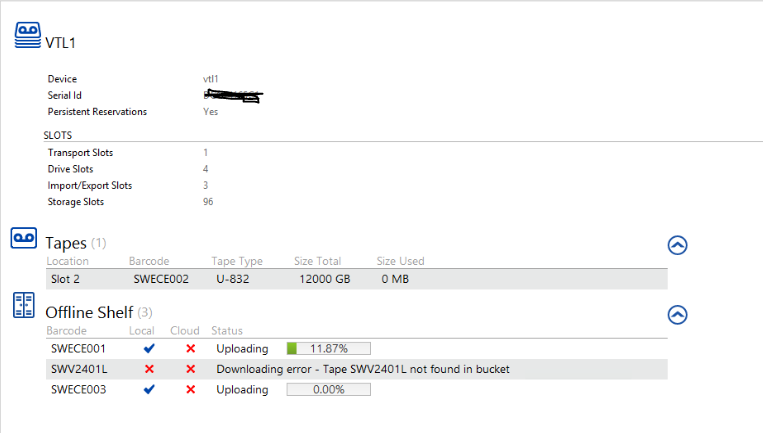

This does not work for me. I don't know if I am missing something. Here is my output:
PS C:\Program Files\StarWind Software\StarWind\StarWindX\Samples\powershell> foreach($tape in $device.Tapes)
      if($tape.SlotType -eq "unknown"){
            write-host "Tape:"
          $tape
As you can see from this output, I have one tape and it is the online one.

Next, to validate we are looking at the right device:
PS C:\Program Files\StarWind Software\StarWind\StarWindX\Samples\powershell> $device
DeviceType             : VTL
DeviceId               : 0x0000004F31926E40
File                   :
TargetName             : iqn.2008-08.com.starwindsoftware:veeambackup-targetvtl1
TargetId               : 0x0000004F3034F180
CacheMode              : empty
CacheSize              : empty
CacheBlockExpiryPeriod : empty
Exists                 : True
DeviceLUN              : 0
IsSnapshotsSupported   : False
Snapshots              :
SectorSize             :
State                  : 0
Tapes                  : System.__ComObject
AvailableSlots         : 95
TransportSlots         : 1
DriveSlots             : 4
ImportExportSlots      : 3
StorageSlots           : 96
Slots                  : System.__ComObject
ReplicationSettings    : System.__ComObject
DriveType              : 8
Lastly, so you can see the tapes are available in the offline shelf, I have attached a screenshot of the management console.
Maybe the issue is because they are still in the uploading phase? If that is the case, what if I wanted to stop the upload and delete them anyways?
Also, how would I remove that one that it couldn't find, SWV2401L?
