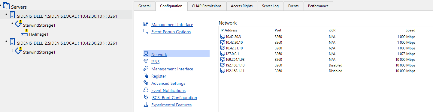

I have a 2 node hyper-converged Hyper-v setup with 4x1 Gb NICs and 2x10 Gb NICs. The 10Gb NICs are connected to a dedicated switch and running on 192.168.1.0/24 subnet. The other NICs are on 10.42.30.0/24 and 10.42.31.0/24. If I configure the heartbeat and sync on the 1Gb NICs, everything works as expected. If I try to configure the 10Gb NICs, they cannot connect. The interfaces work fine, they were used for NAS iscsi connections. Jumbo frames are on 9014 and can ping each other with 8970 unfragmented. I can use it for smb3 connection as well, so the network interfaces are working for sure for other purpose. The nodes report with netstat starwindservice listening on these IPs on port 3260, so the listening side seems to be also working. Firewalls are disabled. iscsicpl can discover the service on the 10Gb IPs.

Are you using 2x10 Gb NICs it Team? We do not recommend any form of teaming for ISCSI and synchronization channels. Please configure these 2x10 Gb NICs in different subnets.
As for ISCSI targets, you have 1 Gb connections active and you are trying to connect ISCSI sessions via 10 GB interface in the same moment, am I right?
If yes, you should disconnect 1 Gb sessions and reconnect with the help of 10 Gb connections. The other way is changing <iScsi Discovery List Interfaces value=”0”/> to "1" in StarWind.cfg file. You will allow several network interfaces for ISCSI traffic.

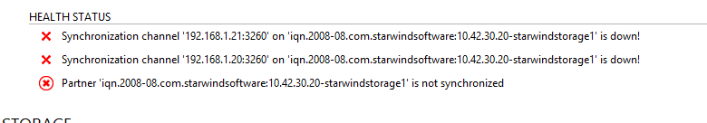

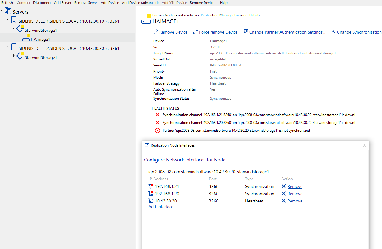

But it still reports, that the sync channel is down. I have attached some screenshots as well.
My understanding was, that if the iSCSI server is configured to listen on 0.0.0.0, then it will accept connections on all interfaces.

I have resolved it. I have smelled something fishy with the Mellanox cards, so I started investigating the parameters and drivers. As it turned out, on one server the Mellanox driver was 5.3, on the other one 5.1. That caused some kind of comm problems I suppose and could not sync. I have pulled up the drivers on both servers to 5.5 and it is synching now (very fast :-) ).
