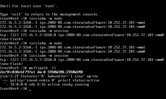

but before it does, I can say the output of multipath -ll is blank. But immediately after reboot, it is not. I have attached a screenshot of the xen server node looks like after a reboot.

The output of multipath -ll changes.. first it shows one storage repo, then the second, finally they all go away and results are empty.

Node is back up and running. Below is the good multipath -ll output
[root@xs4 ~]# multipath -ll
2ec9fc038c6f797a1 dm-0 STARWIND,STARWIND
size=3.2T features='0' hwhandler='1 alua' wp=rw
`-+- policy='round-robin 0' prio=1 status=active
  |- 20:0:0:0 sdb 8:16 active ready running
  |- 21:0:0:0 sdc 8:32 active ready running
  |- 22:0:0:0 sdd 8:48 active ready running
  `- 23:0:0:0 sde 8:64 active ready running
[root@xs4 ~]#
