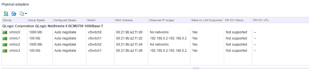

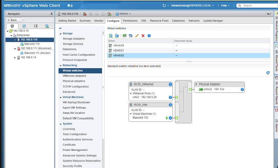

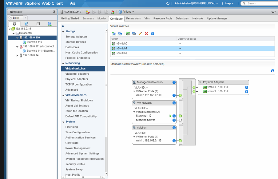

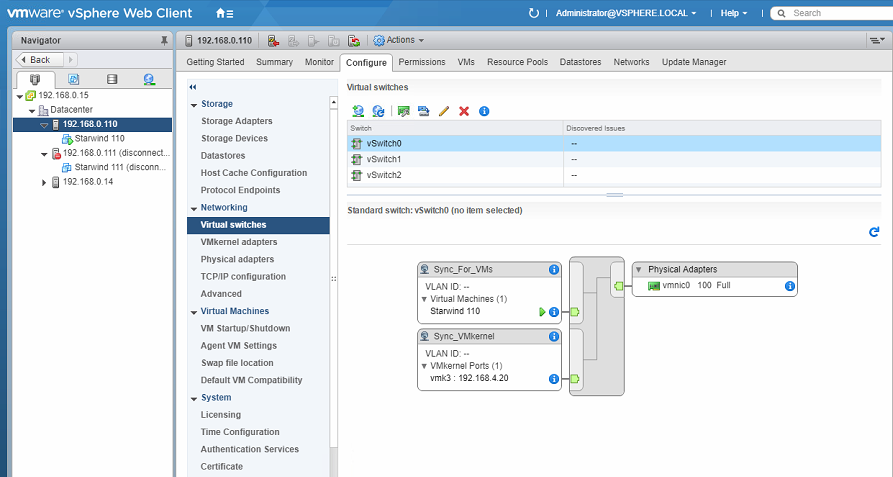

Ok I have taken some screen shots of my configuration. The Vswitch network settings are exactly the same for both hosts except my 192.168.0.111 host has the iSCSI VMkernal as 192.168.5.10 and the Sync as 192.168.4.10. Could someone tell me if my configuration is incorrect?

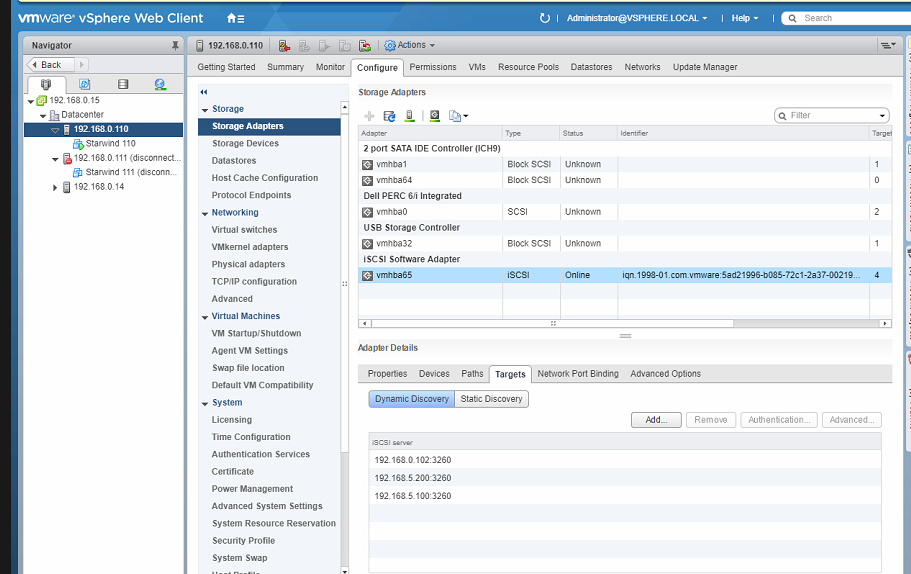

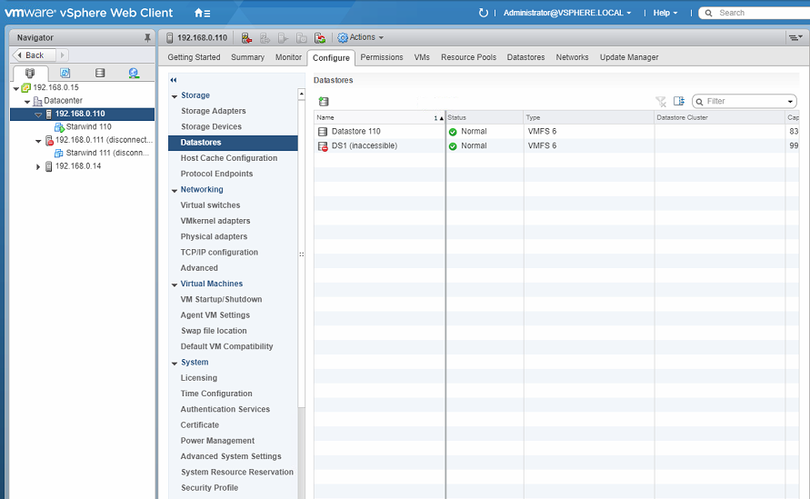

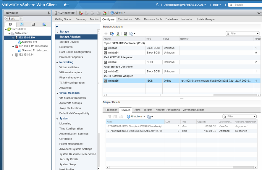

Here are some screen shots of Devices, Targets, and Datastores
Mon Jun 18, 2018 11:10 pm
From what is seen in the screenshots, unfortunately you failed to follow the referenced guide completely.
1. Your physical links are 100Mbps, whereas https://www.starwindsoftware.com/system-requirements state that 1Gbps NICs are required for iSCSI and Sync. This type of networks may potentially work, but is not guaranteed to.
2. You have created VMkernel for the Synchronization link, while the guide does not instruct to do so. You might want to remove it to comply with the steps described in the guide.
3. Why is 192.168.0.X (Management network IP) present among the Dynamic Discovery portals? The guide instructs to configure these settings by discovering only the iSCSI IPs of the StarWind VMs. You might want to remove that IP from the Dynamic Discovery portals list.

2. I was confused about the VMkernals because the guide says "172.16.10.x subnet is used for iSCSI/StarWind heartbeat traffic, while 172.16.20.x one is used for the Synchronization traffic". The only way I found to assign an IP address/seperate subnet for the Sync traffic was to create a VMkernal just like with the iSCSI VMkernal. How else am I supposed to assign the Sync traffic an IP?
3. The Management network IP was already there and I wasn't sure why so I just left it.

172.16.20.x -you can use this subnet and assign IPs on the network adapters inside StarWind VMs. But you do not need VMkernel on vSwitch for Sync.
And please remove Management IP from Dynamic targets.

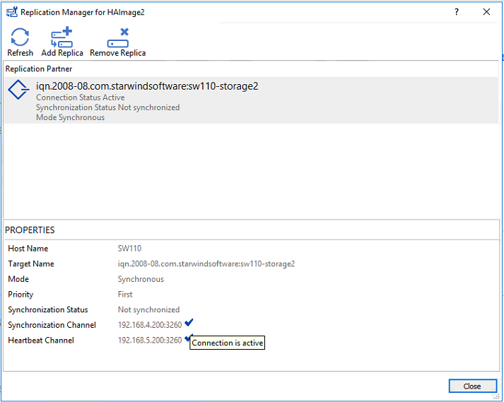

Now the problem I have is I was trying to test out the HA by unplugging the ethernet cables from one of the nodes to see if the other would take over, which it did... sorta. The problem is now I cannot get the two nodes to resynchronize. StarWind shows the Sync and heartbeat channels as ok but they won't auto resync even though it's enabled. The Synchronization option is greyed out. vCenter shows "Network uplink redundancy lost" on one of the nodes but all the vmnics are connected fine. I don't understand why it's not syncing. The NICs are connected fine.

Fri Jun 22, 2018 9:11 pm
Disable Jumbo frames (MTU) both on your vSwitches, VMkernels and inside the StarWind VMs. Your network adapter is QLogic, which is based on Broadcom chips. These chips have a random issue with Jumbo frames processing, when all of a sudden synchronization is dropped and cannot be reestablished until this setting is reverted to standard values (1500/1514).
