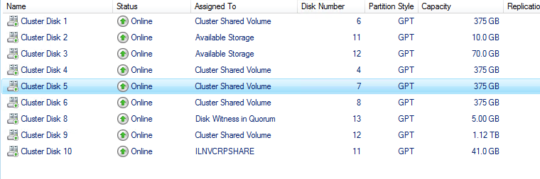

After adding starwind to each of the my 4 hyper v nodes and confirming connections/replication and MPIO I've still not had success live migrating after removing the previous cluster shared volumes.
The original CSV was a freenas solution with multiple disks and disk witness. The new config is the last 3 hard drives in the snapshot:
I moved all the VMS and their configs to the new csv and configured a starwind quorum disk. While the freenas CSV's are still attached and available I am able to live migrate freely between all 4 nodes, the moment I remove even one of the CSV's from the original freenas they lose the ability to live migrate (Quick migration still works). I'm working on the assumption that there's some cluster data still on the old CSV's but I'm not seeing it. I've already set each host to default to the new CSV.

Is the behavior your described specific to all VMs or just some of them?
Do all of your Hyper-V nodes have the same hardware, particularly CPU? If not, did you enable the checkbox in the VM config's CPU section, which allows to migrate VMs between the hosts having different CPUs?
Is the update level of the Hyper-V hosts the same?

Could you clarify the environment we are talking about? In your first post you mentioned Hyper-V, in the latest one you speak about ESXi. The screenshot shows Microsoft Failover Cluster setup though.

I meant to clarify the current cluster is on a hyper-v block that USED to be ESXi.
I did identify the problem, the configstorerootpath (SP?) was on one of the old csv's. Had to shutdown the cluster and modify the registry to get it back.
