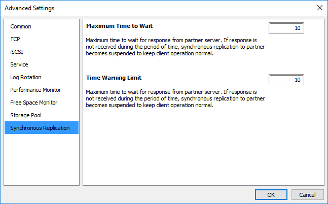

As for configurable amount of time, for now it defaults to 10 seconds. If you want to change that, in the StarWind Management Console go to the Advanced Settings for the selected node:

That setting did not affect the time between network failure, and the "Not Synchronized" condition. Not really sure what that setting actually does. Performed the following test:

Disconnected the Dedicated Sync Channel NOT the heartbeat Channel. Nodes quickly became "Not Synchronized" (after about 13 seconds). This behavior does not seem to happen when both the heartbeat and the sync channel are simultaneously disconnected. It appeared to wait the configured time before marking nodes "Not Synchronized".
Our goal is to have this configured parameter respected if only the Sync, not the heartbeat channel is disconnected.
Thu Apr 05, 2018 11:29 am
After changing the setting in the picture you need to restart the service for the setting to be applied.
