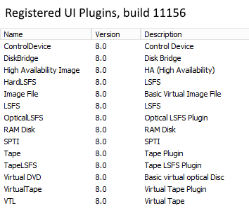

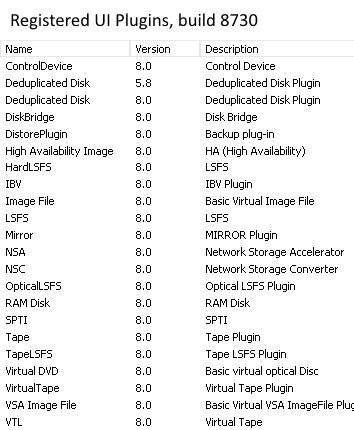

Also, there appears to be a difference in the volume of "Registered UI Plugins" between our older prod 8730 and newer dev 11156 environment builds:
StarWind Version Plugins v8730.png (9.54 KiB) Viewed 9508 times
StarWind Version Plugins v11156.png (7.58 KiB) Viewed 9508 times
How do we manage these?

Mon Dec 11, 2017 12:19 pm
InphinitePhractals,
You do not need to worry about the differences in those plugins. In your 8730 setup, you have some plugins that were just residual and are no longer supported in the latest version. This is the reason for having a different list of plugins.
