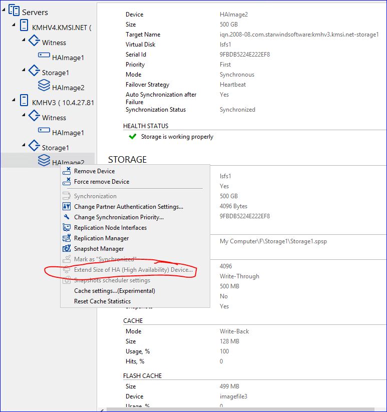

I followed your excellent, clear instructions, Sergey, and had no problem upgrading to version 11456.
However, I still seem to have exactly the same issue -- the Extend option is grayed out and unavailable. I've attached a screenshot. Can you see anything wrong?
-- Ken
Screenshot of grayed-out extend option in menu
"In theory, theory and practice are the same, but in practice they're not." -- Yogi Berra
Sergey (staff)
Posts: 86
Wed Sep 27, 2017 10:24 am
Dear Ken. Now the issue is clear for me. LSFS device cannot be extended at the moment. This will be implemented in one of the upcoming updates, not in the nearest one though.
