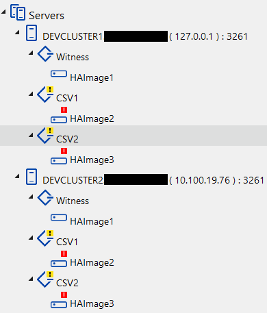

Everything had been running great, and resilient, for about 2 months until after a recent restart. Now all of our CSVs won’t synchronize:
1 StarWind CSVs Down.png (7.42 KiB) Viewed 32955 times

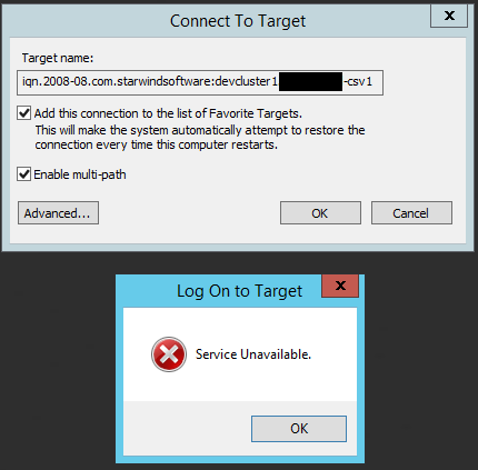

However, when I attempt to connect the Inactive target I get a dialog saying “Log On to Target - Service Unavailable.”:
3 Log On to Target - Service Unavailable.png (13.81 KiB) Viewed 32955 times
I tried restarting the "Microsoft iSCSI Initiator Service" service as well as each machine and no dice. Any ideas?

As far as I can see, your devices have red exclamation marks in the StarWind management console. I can conclude that your CSV1 and CSV2 devices are "Not Synchronized" (that's why you can't connect them via iSCSI).
Firstly, you would need to discover which node has the most recent data. To discover it, you can compare Application logs and find the node with the lastly synchronized devices.
Follow these steps to resolve this issue:
With Management console
1) Open StarWind Management console on the node which has most recent data.
2) Right-click on the CSV1 device (HAImage2 in your case)
3) Click "Mark as Synchronized"
4) Once you will mark it, StarWind will start the synchronization.
