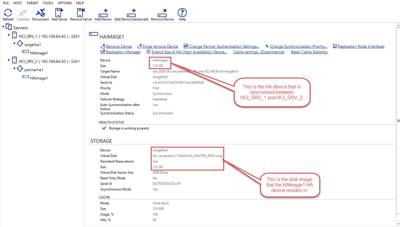

In the free version of this product, or if you are using the PowerShell scripts, you have a file called "extendImageFile.ps1".
If you customize and use this file to extend your image file, you don't actually extend your HA device.
For example, your example is set to extend the image by 100MB per run.
When you run the scipt, it will extend the disk image by 100MB each time, but the HA device stays the same size.
Through the GUI, when you extend the HA device, it extends everything for you.
Is there a way to extend the HA device, across all HA hosts, with PowerShell?
Here is an example of what I'm seeing when I run the PowerShell script.
The HA Device is at 110GB while the disk image is at 120GB.
The device vs. the image difference.
Hope this helps.
