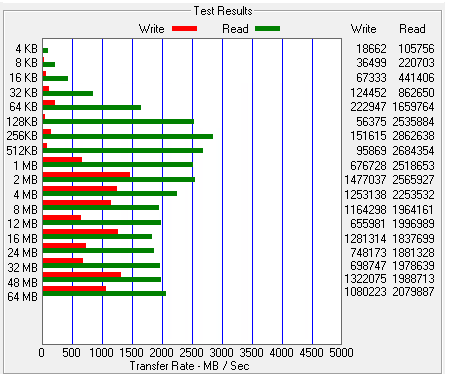

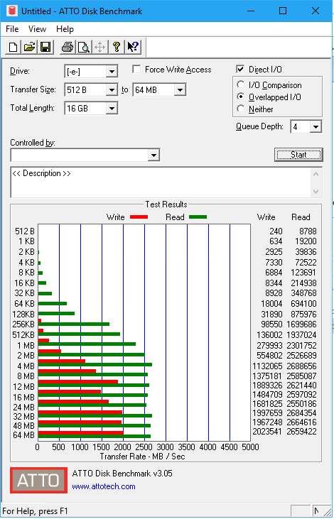

I've attached a screenshot showing raw disk performance for D: where the image files sit. Easily capable of 6GBps.
Replicated and non-replicated imagefiles show similar results. I'm using ATTO benchmark.
Raw disk performance

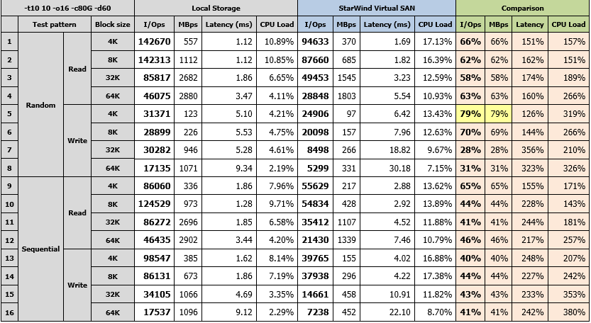

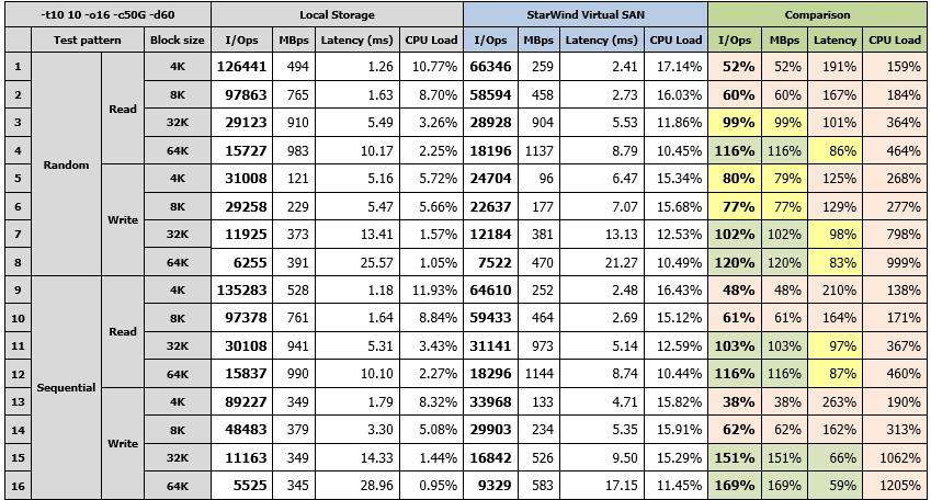

starwindtest
starwindtest
See above for results from your testing tool as well.

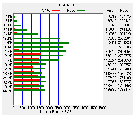

Here is the same test re-run:
Any other ideas?

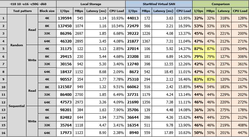

I've done what you have requested. Here is the latest test results:
As you can see it's still lacking - do you have any other ideas?

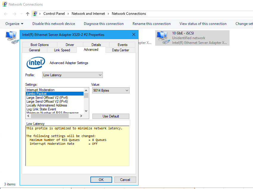

Have you checked your iSCSI NIC settings within Windows on the Starwind server?
I saw a dramatical increase in throughput when I changed the NIC settings profile from the standard one called "Standard Server" to "Low Latency" (within the advanced options for the NIC).
I have the X520 NIC, so I'm not sure if this is an option for you.

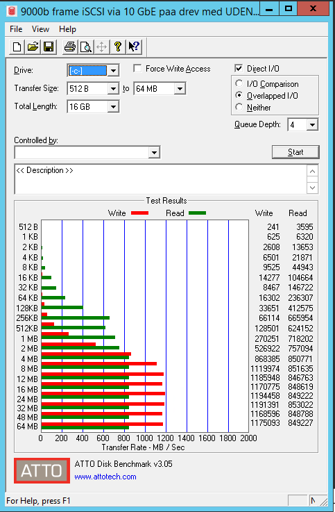

My setup is 8xSSD in a RAID5 without any caching on the controller nor in the Starwind iSCSI. I'm only using 1x10GbE and it is now saturating that link in one direction (dunno why read is slower than write).
The only two changes I made was to enable Jumbo Frames and switch to the Low Latency profile.

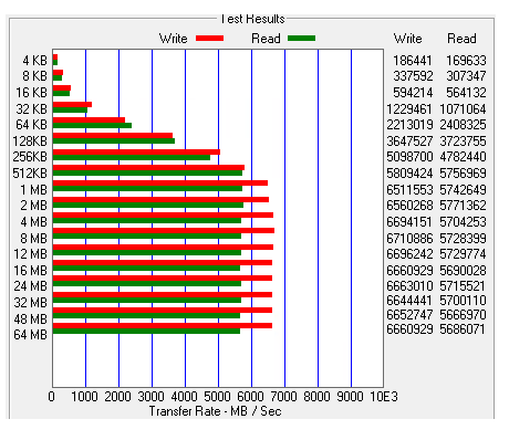

Local RAID:
local storage.PNG (29.74 KiB) Viewed 74427 times

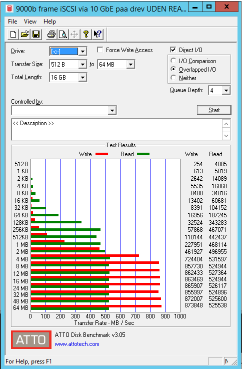

Jumbo Frames enabled and Standard Server profile:
Jumbo Frames enabled and Low Latency profile:
