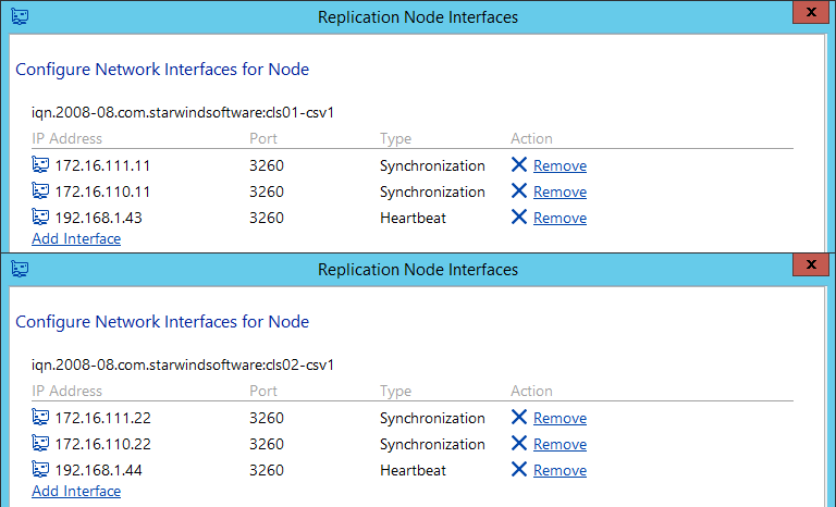

The issue seems to have been with Starwind, I've spent most of today going through my iSCSI/MPIO configuration and it all appears to be exactly as described in the documentation, as if it should work how it's supposed to. The iSCSI settings for one Node, for example:
Disk0 CLS01-CSV2
Starwind HAImage2 replicates over 172.16.110.11/172.16.111.11 & 172.16.110.22/172.16.111.22

Disk1 CLS01-CSV1
Starwind HAImage1 replicates over 172.16.110.11/172.16.111.11 & 172.16.110.22/172.16.111.22
Name From To
CSV1 local Default 127.0.0.1
CSV1 partner cable 0 172.16.210.11 172.16.210.22
CSV1 partner cable 1 172.16.211.11 172.16.211.22

I followed something very similar to that (StarWind Virtual SAN™ Hyper-Converged 2 Nodes Scenario 2 Nodes with Hyper-V Cluster) when I set it up. I've been through all the iSCSI and MPIO stuff in some detail trying to get a grip on it, so far I have the following, which is quite a lot of info but will hopefully help. The main thing I can see is that everything appears to be the same on both nodes, with the exception of the Witness disc:

I've been reading https://www.starwindsoftware.com/techni ... luster.pdf this morning. I've found one thing which doesn't match the document I used to set mine up.
My nodes have, amongst other things, a pair of crossover 10Gbps cables between them. At the moment I have Starwind synchronisation and iSCSI running over both cables. This document seems to be saying I should have synchronisation on one and iSCSI on the other, is that right?
I'm beginning to suspect this is wrong:
What if:
I remove the w.x.110.z interface from each of those, then restore it as Synchronisation and Heartbeat.
Then I remove the w.x.111.z and the 192.168.1.43 interfaces altogether.
Then I go to iSCSI Initiator Properties, Discovery and remove the w.x.210.z interface.
That leaves me with Heartbeat and Synch on one cable and iSCSI on the other. Assuming that's the goal, would that work?

We have investigated the logs and found that devices were not synchronized because underlying storage issue.
As for the network reconfiguration in StarWind Management console it can be done as suggested. Just use one cable for Synchronization and another one for ISCSI and Heartbeat.

I've learned that you can't rely on the RAID management software to tell you if there's a problem, so now I have a filtered event log getting items from the System log in the Task Category "Storage Service" which has much more useful information for you.
With Michael's help I also sorted out my Starwind/iSCSI config which was out of date according to the current notes from Starwind he linked to above, those of you who can read MPIO reports (another thing I have learned to do recently) will see what I mean - basically I had too many paths and the wrong MPIO policy.
