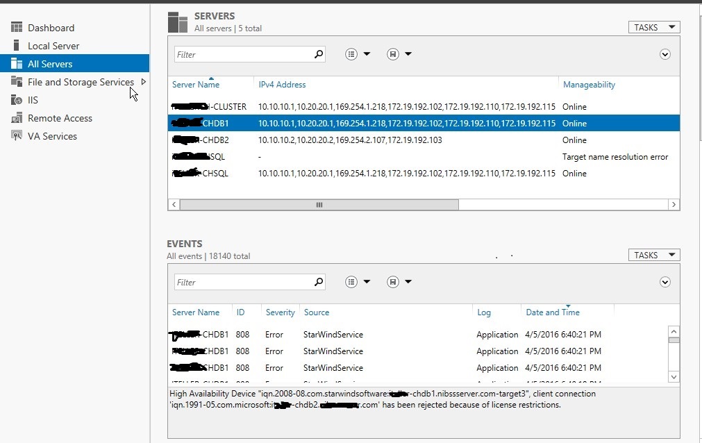

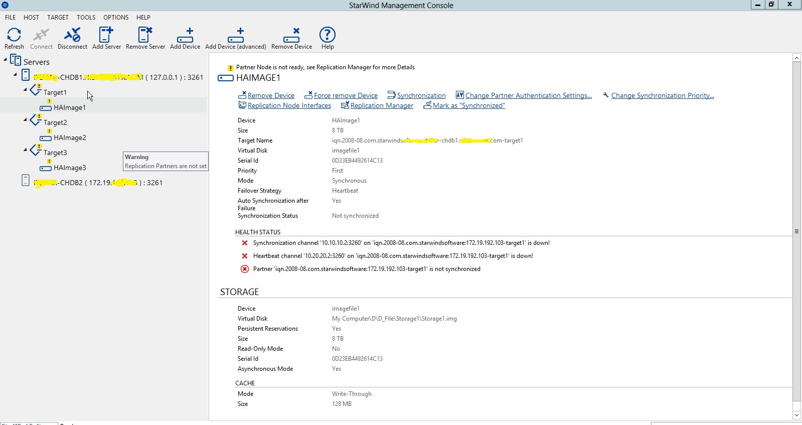

I am having a WFC of win server 2012 (with node1 and node2) configured with a shared storage on my Node1. I also installed SQL server failover cluster on the server on the installed WFC. I then tried replicate the shared storage from node1 to node2 and it worked perfectly in my test machines.
I then restarted the servers and discovered the storage weren't available for the cluster (both WFC and SQL server failover cluster). On the Starwind console I discovered my heart beat and sychronization channel was down (see attached image3). I also check my server event log and discovered a message related to license (please see attached image4).

PoSaP
Posts: 49
Joined: Mon Feb 29, 2016 10:42 am
Thu Apr 07, 2016 2:06 pm
Hello
Could you clarify few things:
- Did you double check your second node(Node is online, starwind service is working properly, NIC`s are working well)
- What starwind version you are using(Help > about starwind management console)
Please note, latest version V8 is build 8730 (11 November 2015)
