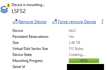

When rebooting my SAN (after powering off all VMs and hosts), LSFS volumes take a long time to mount (2+ hours) and seem to be stuck at 100%:
Mounting stuck
Mounting stuck

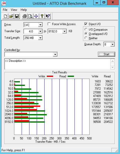

Created a test target. 20 GB, no cache, flat file (not LSFS).
Then I connected to it via local iSCSI initiator (127.0.0.1).
ATTO test results to the RAID volume directly:
Direct to RAID Volume.png (20 KiB) Viewed 13139 times
ATTO test results to the Target via loopback:
To Loopback iSCSI target.png (20.7 KiB) Viewed 13139 times
As you can see there is a serious discrepancy between the two. Additionally, the network should have nothing to do with the slow mount times...

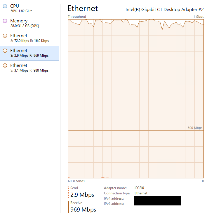

Regarding iSCSI performance, I ran four threads against my two 1Gbps NICs.
Here are the commands I sent from the client (also two 1Gbps NICs):
C:\iPerf\iperf3.exe -c 192.168.200.10 -l 9000 -t 120
C:\iPerf\iperf3.exe -c 192.168.200.10 -p 5202 -l 9000 -t 120
C:\iPerf\iperf3.exe -c 192.168.210.10 -p 5203 -l 9000 -t 120
C:\iPerf\iperf3.exe -c 192.168.210.10 -p 5204 -l 9000 -t 120
Here is a view of taskman showing the throughput for the NICs:
iPerf-four threads.png (29.7 KiB) Viewed 13106 times

I've got an idea. A point here that I've noticed is that your local results could be so high compared to starwinds because of RAID controller internal caching. AFAIK starwind somehow avoids RAID controller caching and thus shows you such a low results. Try testing with a larger file size (like 5-10GBs) to penetrate RAID controller cache and to see if the difference still persists.
