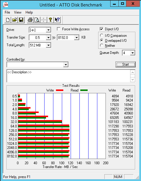

So I ran tests using ATTO Disk Benchmark on a VM on my ESXi Host and on the local disks on the server hosting the StarWind Virtual SAN software. I disabled all cache and the only VM running was the one that was running the tests (a brand new server 2012 r2 install, nothing else on it). I have one NIC between the server and the ESXi host. I ran three tests on a VM on the ESXi host, one on a RAM disk (called RAM Disk Performance over iSCSI), one on the device image stored on HDD's in a RAID10 (called HDD Performance over iSCSI), and one on SSD's in a RAID0 (called SSD Performance over iSCSI). I also ran two tests on the local server hosting the StarWind virtual SAN software, on the same set of HDD's and SSD's (I shut down the VM and stopped the StarWind service to make sure there was no other disk IO). The test screen shot on the HDD's is called (HDD Local Performance) and the test on the SSD's called (SSD Local Performance). Thank you for all the help! (Sorry for having to zip up the screen shots)
RAM Disk Performance over iSCSI.png (130.64 KiB) Viewed 25226 times
