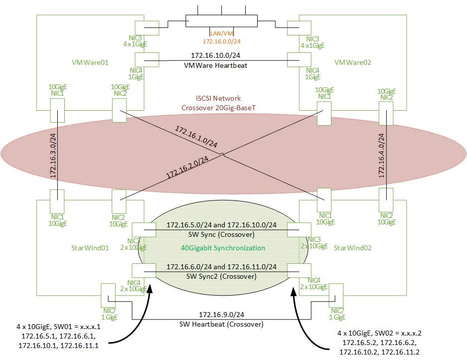

From looking at the setup; the only thing I find would be the culprit would be the 4 x 1gb; running VM traffic and SW Sync/Heartbeat. VM Traffic should be seperate from SW Sync.
Are these individual links or did you team them together? Avoid teaming on the Starwind systems; and use multiple subnets/VLANs to guarantee network segregation. If you can avoid it; avoid using switches; or make sure they are fully managed and able to use 9k Jumbo frames.
You can see in my diagram the individual subnets for every connection. You could probably Team outside Starwind virtual and present one teamed NIC to the VM; but I have not had time to test this scenario.
You'll also want to tune TCP as well for your specific NICs (TCP Offload, Chimney, RSS Queues, etc.)
Basically break your system components into individual segments and validate that they are working as well as they can.
Iperf will test NIC/bus speed on the systems; but not hard drive/IO. You'll want to use IOMeter to test IO on the systems.
So you test local system items (storage; nics; etc). Then test cross-system NICs. Then test locally attached iSCSI. Then test remotely attached iSCSI. Usually in that order; since testing remotely is worthless if local does not work properly or at full potential.
