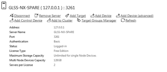

Free License information - Attached Screenshot
License Info
License Info

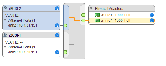

iSCSI vSwitch Diagram - Attached Screenshot.
This is a dedicated network with one switch. Two ports from each host, each in its own subnet, dedicated to iSCSI traffic. Mirrored setup on the NAS.
vSwitch Diagram
vSwitch Diagram

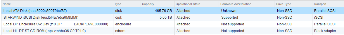

Storage Devices - Attached Screenshot.
Storage Devices
Storage Devices

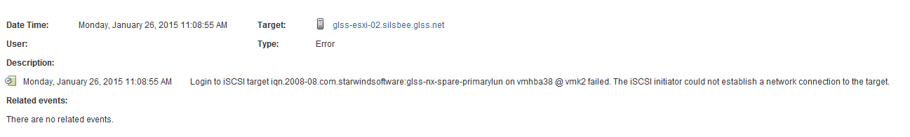

VMWare can see the device, but any further than that and the client seems to timeout. It lists a login error in the Events section almost immediately after a HBA Rescan. If you try to select the datastore, the web client hangs for a long time before the device grays-out and becomes disconnected. I will attach the Events Screenshots to the next post.

Events Screenshots
List:
Event List
Event List
Detail:
Event Detail
Event Detail
