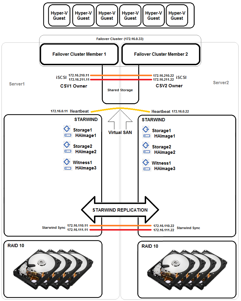

As I progress through setting up the test version (I've only had to start over twice so I'm not doing too bad) I've come across another question.
Page 13 of the Hyper-Converged 2 Node document says "It is recommended to create at least one CSV volume per cluster node" - so in the two node scenario I need 2 x HAImage and the witness? Why is that? I'd rather have one big space instead of breaking up my storage.

If your running Hyper-V on the same node that your running Starwind, you can take advantage of local loopback acceleration to access that local CSV directly, and set your MPIO policy to failover to the other node. You'd do the same on the parnter node, that way they run local workloads on local disks CSV bypassing TCP stack, with having the ability to failover to the other node.
If your Starwind SANs are on seperate dedicated machines from your Hyper-V hosts, it doesn't matter as much and you can create one space and use Round Robin as the MPIO policy to balance requests across the cluster.

So they're mostly working on local physical discs - it's beginning to make sense, yes. I'm almost feeling brave enough to move out of the test environment... :)
My interpretation so far...
