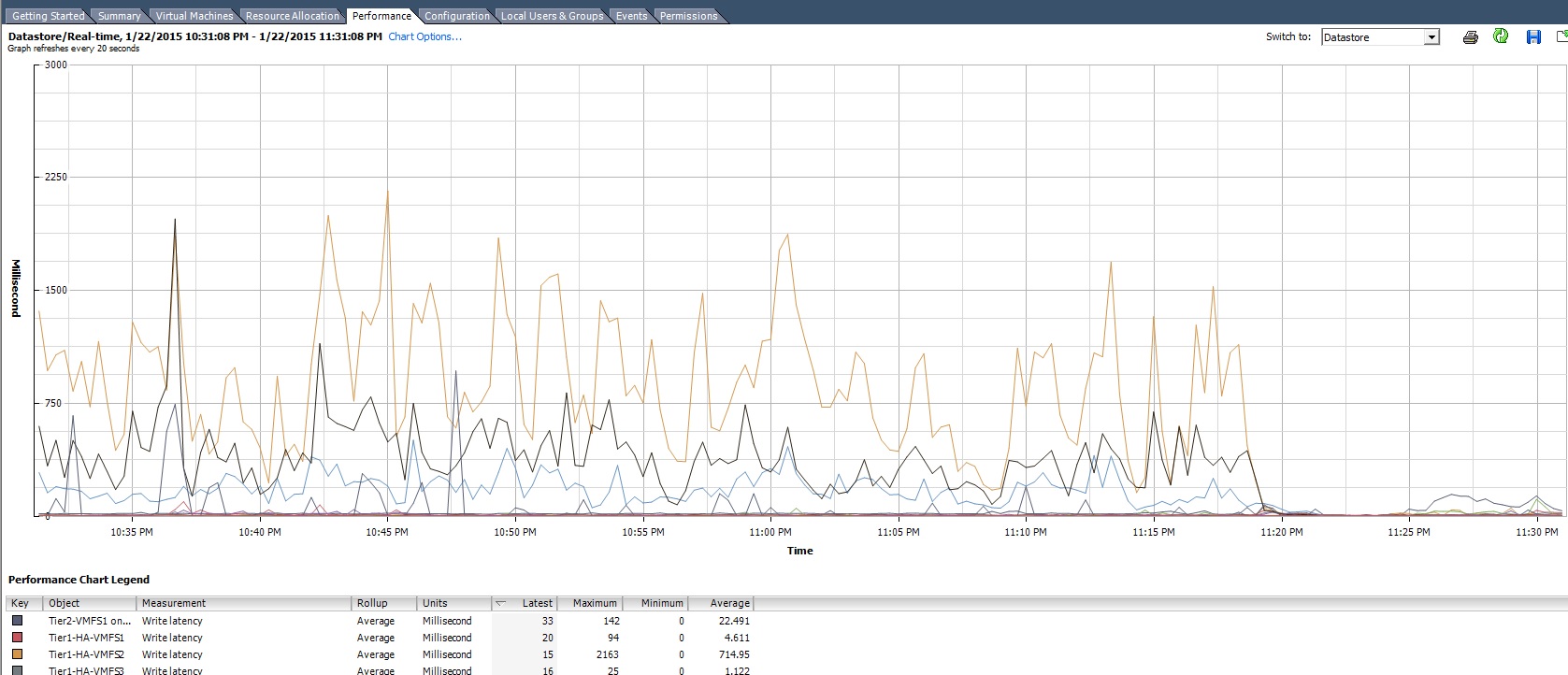

Fri Jan 23, 2015 4:34 am
I've attached a .jpg what latency looks like before and after applying the workaround, which is disabling L1 cache on the HA LUNs. Note the fix being applied around the 11:20pm mark.

lohelle wrote:How do I disable L1?
In the Starwind.cfg file, look for instances of "wb" or "wt", corresponding to each cache type, and replace with "none"
This only needed to be done for LUNs that were in an HA configuration.
Enjoy
