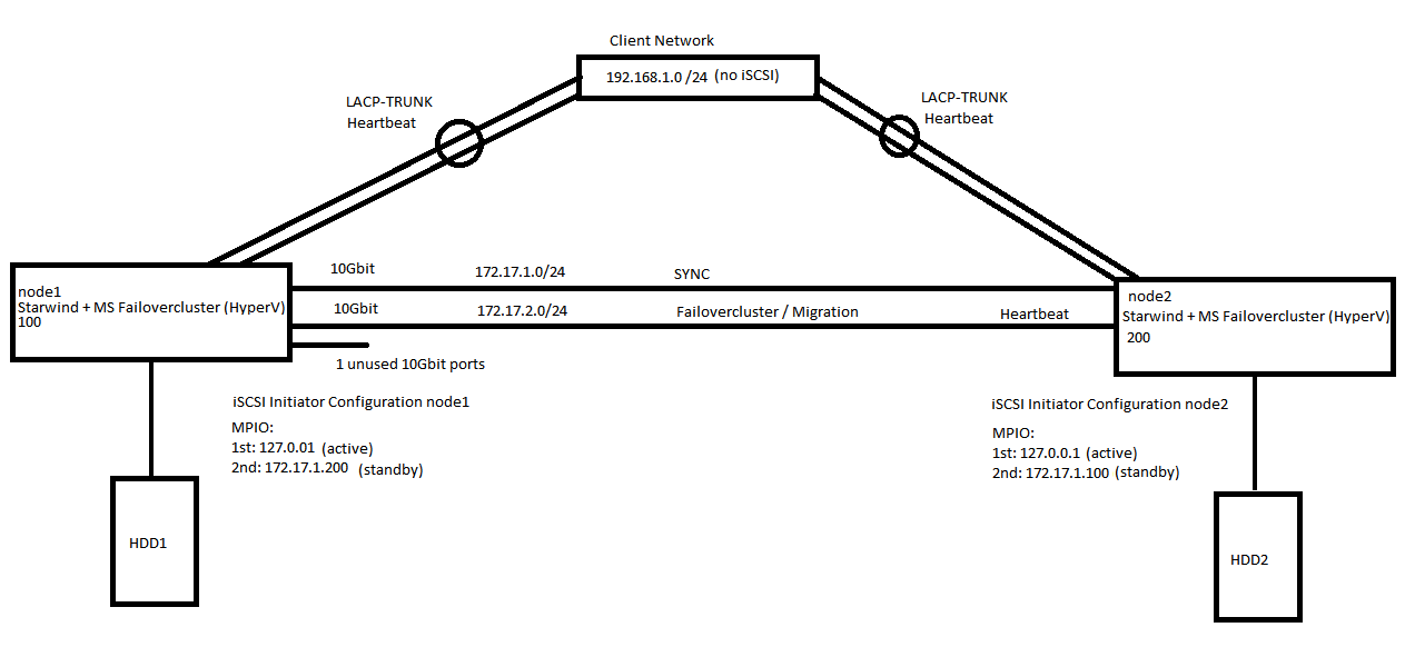

I've got a follow up question about point 5:
I thought it may be possible to use one of the 10gbit connections (point 2 point) using the setup i've described with the drawing.
Currently I'm using the Sync Network for that, if this is a very bad idea I could provide a third p2p connection.
Kind regards
Actual Setup.
Actual Setup.

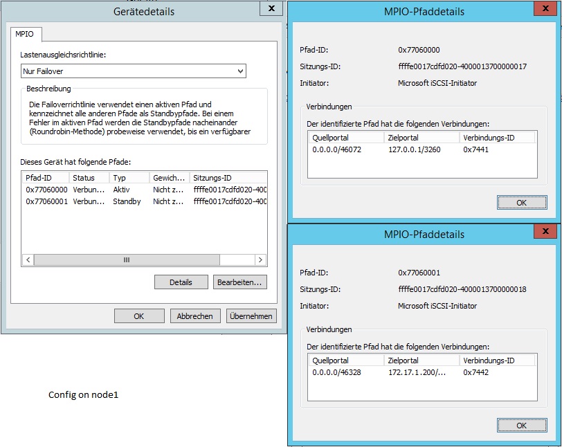

i've made a couple of additional screenshots to make clear what i'm trying.
Anatoly, I've mailed you the logfiles for this configuration(together with the cluster validation test results) from both clusternodes two days ago, did you recieve them?
(be aware, the Subnets differ as I don't post real world IPs in public forums.)
Kind regards
MPIO Config
MPIO Config
