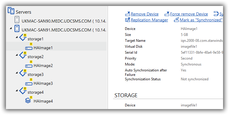

I've shutdown my lab one node at a time yesterday: first SAN90 and then SAN91. I've powered them back up today and all three storage devices are shown as not synchronised.
Question #1 - is this by design? I thought auto-synchronisation would have kicked in? So in our procedures, we have to document manually re-synchronising the nodes in case both nodes were shutdown - as could easily happen in a power outage. The UPS will send out the signal and everything shuts down cleanly.
I did notice that the node that was flagged as having the master copy was SAN91 which was the node that was powered down last so that makes sense.
Question #2 - will this re-sync have been a re-sync of just differences or an full re-sync? I infer the former as it finished the re-sync pretty quickly. Or do the rules that were mentioned elsewhere a few days ago kick in, i.e. it would do a full re-sync in some circumstances.
Question #3 - what state are the MPIO iSCSI connections in whilst in the un-sync'd state? There are MPIO iSCSI connections to both nodes - where do the writes go before one carries out the manual sync?

Hmm, that's strange. Gone through the same process (shut node #1 down, shut node #2 down, bring up node #1, bring up node #2) and it resynchronised automatically this time.
Mon Aug 04, 2014 9:14 am
I`m not sure what exactly went wrong here. Could you please doublecheck if everything been done according to our HA Maintenance and Configuration Changes Guide http://www.starwindsoftware.com/ha-main ... on-changes
Depends on the version - v6 assumes full sync, v8 assumes difference sync in most of the cases.
The node that is the source of synchronization should be the only node that takes care of the reads and writes from client machine. I hope that answers your question.

I agree as it's a little vague which node is the correct source. I can also confirm that auto-sync is not starting after a clean shutdown and you have to manually re-sync the nodes. To confirm steps:
  1. No iSCSI targets connected, i.e. not IO to the SAN
  2. Shut down SAN91
  3. Shut down SAN90
  4. Power up SAN90
  5. Power up SAN91
Storage is not synchronised. If you start sync on SAN90, it syncs from SAN91. If you start sync on SAN91, it syncs from SAN90.

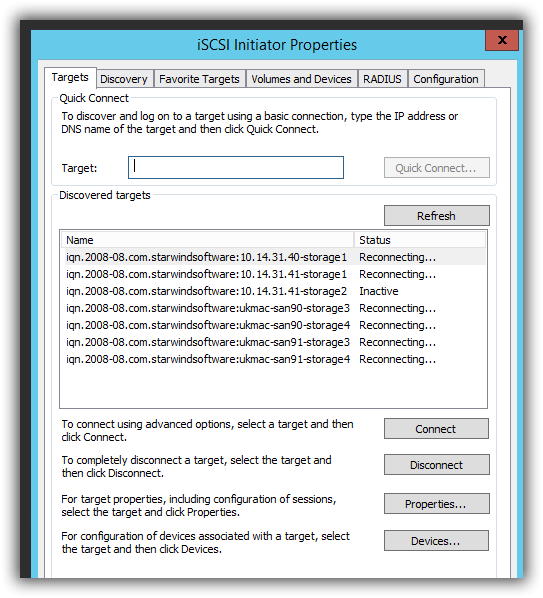

Here's another question. Two-node HA. Clean shutdown of both nodes SAN90 and SAN91 and the TEST90, the Windows 2012 server with iSCSI connections to both nodes. Assume this was a power outage situation where the UPS shut everything down cleanly.
Power restored but assume something has gone wrong with SAN90 - it hasn't powered up for some reason. SAN91 has come back online as well as TEST90. However, iSCSI is stuck in reconnecting (see attached screenshot).
At present, our entire infrastructure is down! Assume we can't get SAN90 up and running quickly (maybe we did a Windows update and it went horribly wrong). How do we bring the SAN back online cleanly on just SAN91?
robnicholson
Posts: 359
Tue Aug 05, 2014 2:17 pm
I've just found "Mark as synchronised" which I assume is the option to be chosen in the disaster scenario? It says it'll start processing client requests immediately - sounds like that's what I want it to do. The iSCSI initiator on TEST90 is still saying "Reconnecting" - will leave it a little longer to see if it manages to reconnect automatically.
