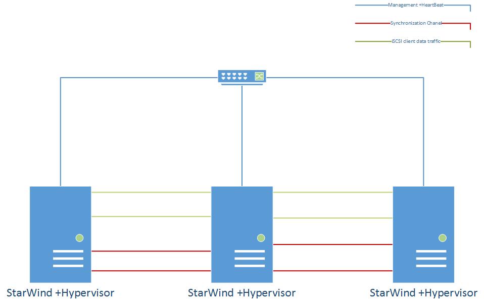

I am struggling in this exact same situation and I don't have access to any 10 GbE switches. You say that it is difficult but it does not sound impossible, so could you elaborate with some simple diagram or explanation on how setup the sync and iSCSI data channels with three nodes and a pair of 10 GbE NICs on each node without a switch? I do have 1 GbE NIC ports for the virtualization and clustering through switches so that part is not an issue.
Mon Jul 21, 2014 2:37 pm
Hi!
Here is how it looks:
Let the switch don`t confuse you here - it is not directly required for StarWind, it is just for management.
I hope that diagram makes sense for you, but if not - just ask anything you want.

Does it mean that server 2 (the one in the middle) actually needs nine network ports to make it work? With that design, doesn't it also mean that when server 2 is offline, that server 1 and 3 won't be able to communicate with either other with either sync or iSCSI?
lohelle
Posts: 144
Mon Jul 21, 2014 3:19 pm
I guess the green links are between server 1 and 3, not going via server 2.

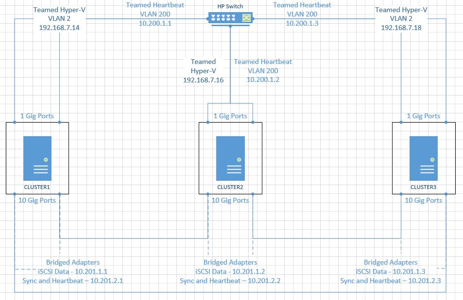

The way I've been experimenting currently with my current configuration is to actually bridge the pair of 10 Gig network ports on each of my servers and assign two ip addresses on each bridge. This seems to allow communication between any server if one of the three is taken offline. I'm not sure how detrimental the performance is with network bridges though. This is my current design:

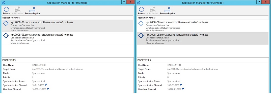

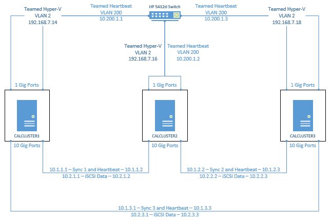

What I've found is that the bridged adapters seem to really slow everything down and when one node is taken offline, the syncing of even a 1GB CSV takes forever. I've had to revert back to an old design. What I found was that I had to fool the cluster creation wizard by temporarily adding a sync channel IP addresses to servers that are not normally part of sync group just to be able to add the server to the cluster group, afterwards I am able to remove it without any issues it seems. Since I am not using two redundant 10Gig switches but direct cable connections, I don't have the ability to vlan the sync channel and the iscsi channel. Do you think that there will be performance issues if I simply utilize two subnets on each adapter port? So far I have a 1GB witness and a 200GB CSV in a cluster and have tested the rebooting of each server and Starwind seems to resync fast and ok when the server is back up. This is my new design:
And this is the replication manager shot from the cluster 2 server:

I hope that not :D
Well, we can try to count it. Do you know the approximate IOPS number that the SAN should handle?
Slingshotz
Posts: 26
Mon Jul 28, 2014 4:55 pm
I will be setting up three CSVs as recommended by your engineer, two 200GB ones and one 1.6TB one, each one hosted by a different primary server. I'm estimating each CSV to only need to handle about 1000-1500 IOPS at extreme peak times with about 300-600 IOPS during normal times. Do you think this is within the capabilities?

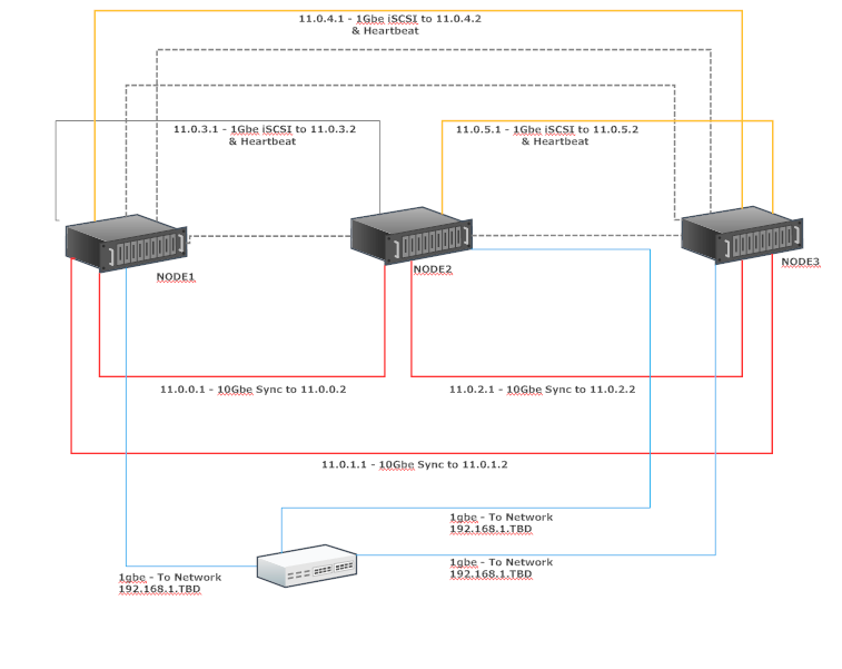

The attached is how it is currently setup and the dotted lines are the additions to the new cluster for extra iSCSI connections (so this is the only change for the new cluster). I currently have a BIG problem with full syncs taking several days to finish and during the time killing throughput for the VMs. I am running 8 (10K SAS) drives in a Raid 5 with two partitions (OS and Starwind storage) It was recommended in the new cluster to RAID 0 the Starwind. I didn't want to have to reconfigure the entire node if (I mean WHEN) I loose a drive, so I am going to mirror two 300GB 10K SAS drives to protect the OS and preventing a Fail-over event if I loose a drive in the RAID 0. Starwind says that the Sync will pull data and unbeknownst to Windows if a drive failure occurs on the Starwind storage (Raid 0 array) so I kinda have a Raid 10 but with the speed where I need it and the redundancy where it is important. I plan to take the remaining 6 bays and putting in 900GB 10K SAS in a RAID 0 I am told this will fix my issues and speed up full resyncs and give me more storage. I am using 10Gbe for sync and Starwind setup the heatbeat and iSCSI on a single 1GB connection and I get over 600IOPS through the CSV (hard to test while it is in production) So going with a RAID 0 and adding two more iSCSI initiators will only increase my performance.
