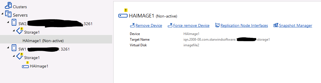

I tried to simulate clean planned shutdown of one Starwind node in 2-node cluster. After node SW2 has restarted and starwind service started up again I see HA image file is in Non-active state. Replication is broken and interfaces are missing. See screenshot.
My config: Starwind v8 (build 7145) @ Windows server 2012 R2, single HA thick volume, connected from ESXi servers.
Please, how to re-connect non-active image and perform clean shutdown in a future? Thank you.
Pavel.

First of all, here are the instructions of what you should do in case when the StarWind went out of sync:
http://www.starwindsoftware.com/starwind-faq#q_11
As about the issue itself, may I ask you to provide me with next information:
· StarWind service logs from all problematic SAN boxes
· Windows Application and System logs (in *.csv format) from all problematic SAN boxes
· Detailed network diagram of SAN system
· Description of the actions that were performed before/at the time of the issue
· Approximate time frames when the issue happened
I`d appreciate if you`ll separate the logs from different servers into the different folders, upload them to some file hosting service and share the link with us.
Thank you

thanks for tip and guide for future, I'll send logs and schema on next test as you wrote. But a few more notes about this case:
  • first of all: device reconnection was impossible in any way, I tried both methods from Q&A you recommended, but I always failed. I had to completely remove devices and targets
  • I configured two node sync without cluster wizard, I used guide from thefinsker user, http://www.starwindsoftware.com/forums/ ... f=5&t=3762, reason is L1 and L2 requirement for HA device, it's only way (as far as I know) how to create HA device with L2 cache. I suspect this non-standard (?) of creation caused my problems on reboot.
  • node #2 lost networking settings at all
  • option "Synchronization" and "Mark as synchronized" was grayed on functional node
I'm going to perform same test again, but with standard cluster device for now.
Regards
Pavel.

second test is still looking OK, no problems with nodes restart. I changed some configuration based on hints:
  • I created cluster with wizard instead of manual creation, L1 cache size has been set manually by direct edit of .swdsk files
  • I used thick disk instead of thin
So it seams OK now. Unfortunatelly I haven't L2 cache. Wizard doesn't allow specify it while cluster is created.
Pavel.
