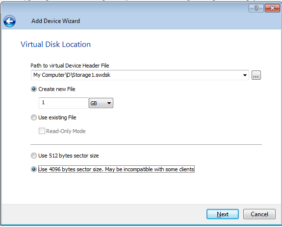

Mon Jun 02, 2014 2:03 pm
Hi!
I think upgrading to the v8 and using 4096 bytes sector size during creating of SW image(see below) should so the job.

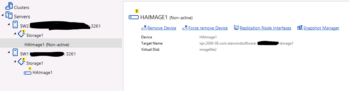

Wed Oct 22, 2014 8:27 am
I tried to simulate clean planned shutdown of one Starwind node in 2-node cluster. After node SW2 has restarted and starwind service started up again I see HA image file is in Non-active state. Replication is broken and interfaces are missing. See screenshot.
My config: Starwind v8 (build 7145) @ Windows server 2012 R2, single HA thick volume, connected from ESXi servers.
Please, how to re-connect non-active image and perform clean shutdown in a future? Thank you.
Pavel.

Mon Oct 27, 2014 10:29 am
Hi Anatoly,
thanks for tip and guide for future, I'll send logs and schema on next test as you wrote. But a few more notes about this case:
  • first of all: device reconnection was impossible in any way, I tried both methods from Q&A you recommended, but I always failed. I had to completely remove devices and targets
  • I configured two node sync without cluster wizard, I used guide from thefinsker user, http://www.starwindsoftware.com/forums/ ... f=5&t=3762, reason is L1 and L2 requirement for HA device, it's only way (as far as I know) how to create HA device with L2 cache. I suspect this non-standard (?) of creation caused my problems on reboot.
  • node #2 lost networking settings at all
  • option "Synchronization" and "Mark as synchronized" was grayed on functional node
I'm going to perform same test again, but with standard cluster device for now.
Regards
Pavel.

Fri Oct 31, 2014 10:19 am
Hello Max,
second test is still looking OK, no problems with nodes restart. I changed some configuration based on hints:
  • I created cluster with wizard instead of manual creation, L1 cache size has been set manually by direct edit of .swdsk files
  • I used thick disk instead of thin
So it seams OK now. Unfortunatelly I haven't L2 cache. Wizard doesn't allow specify it while cluster is created.
Pavel.
