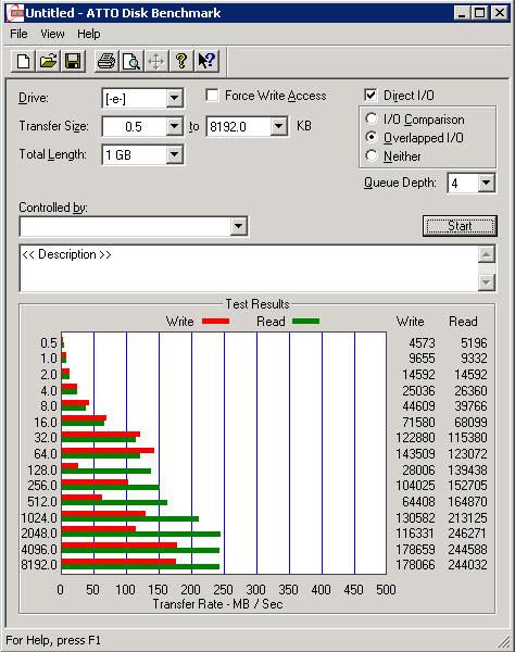

This shows the speed on the local disk
Local Disk ATTO
Local Disk ATTO

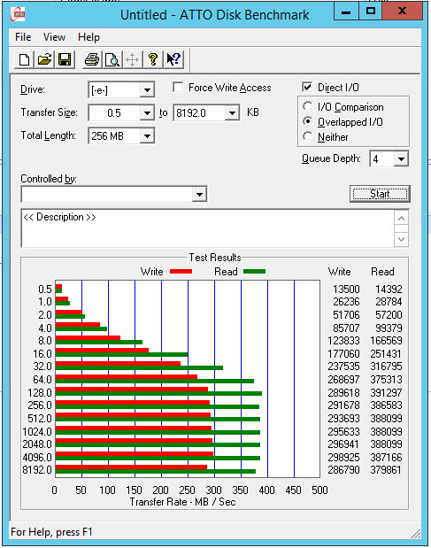

this is the speed via the ESX host i was testing, this has multiple iSCSI connections iops set 1 etc...
RAM DISK via ESX Host
obviously some issues here

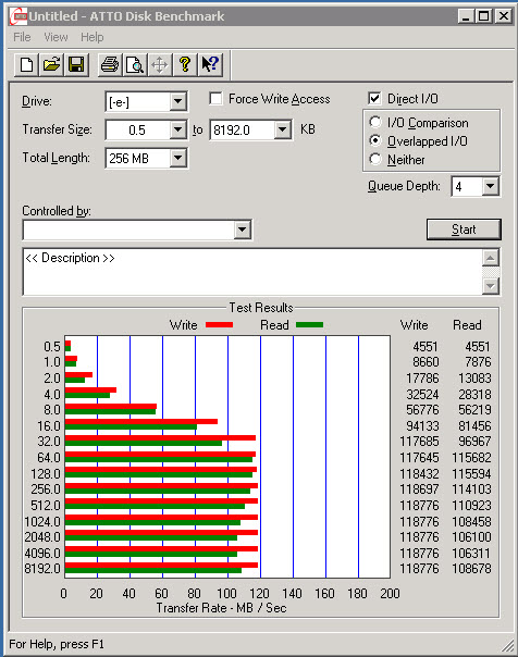

so i connected a physical server (dell 1950 III, on board nic) to the ram disk and i get this
RAMDISK on a physical host single ISCSI Connection
which is about the expected speed of a single connection.

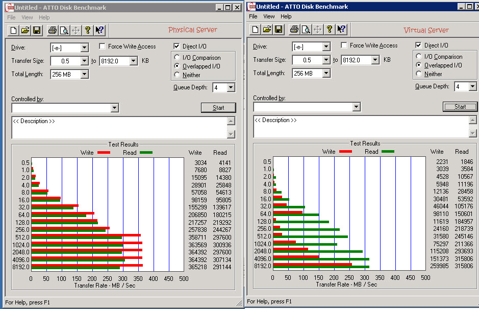

I have tested a RAM Disk on
a) a physical server (dell 1950 iii) quad 1gb links in mpio
b) a virtual server (hosted on our ESX 4.1 box) quad 1Gb Links, Round robin mpio set to 1
Both have jumbo frames enabled
RamDisk Side By Side.jpg (186.09 KiB) Viewed 26480 times
I can't see what else i can do, it appears the disks are fine, it appears the network is fine, the speed appears to be capable on the ESX (the 8096 shows 350/300 and 250/300)
I'm fresh out of ideas, and have spent a little over a month trying to get this sorted, any ideas would be great
