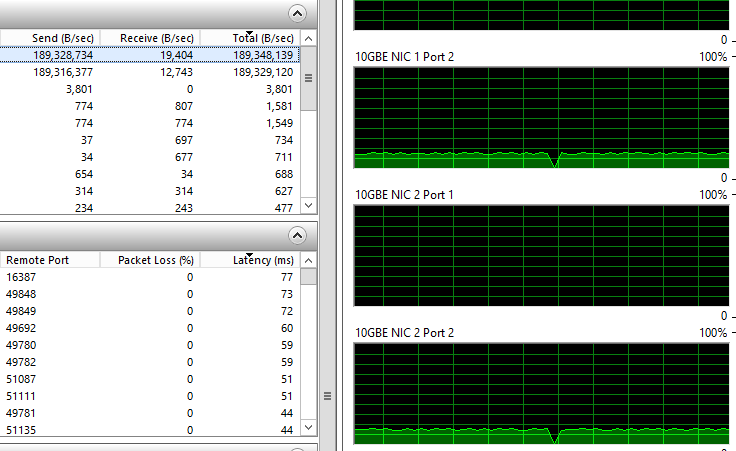

We've got our new portential production starwind environment built and configured and currently doing benchmarking and testing. What I'm finding though, is that I can't get the sync channels to use more than 15% of the available bandwidth when doing a full sync. I've tried changing the sync prioritization the next notch up to full, but it doesn't seem to make a difference.
I've performed full network testing of the 1GBE iSCSI channels and the 10GBE sync channels with iperf and a ram disk for all NICs on all nodes, and they can all saturate the links up to around 99%, so I know the network side of things is working perfectly.

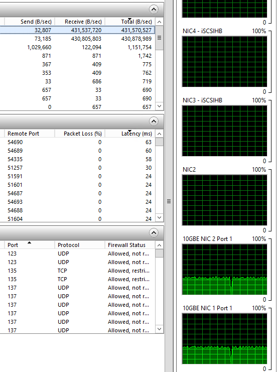

Just an added note. This was a single sync request for one of our 4x1TB Raid0 devices in Starwind. I have another 3 of these 4TB arrays on each node. I manually started the sync on the other 3 nodes, and I'm seeing the Sync channel usage go up to around 430mb per 10GBE NIC, so around 40% utilisation.
So the question is, is there a way to make a single sync operation use more of the 10GBE connection?

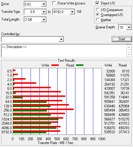

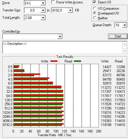

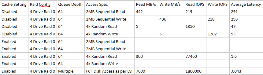

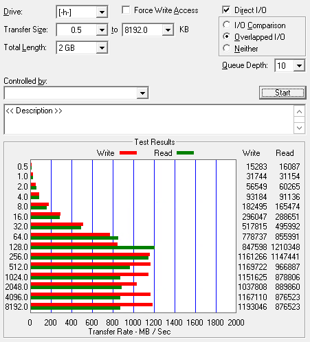

Yes, I have run those Anatoly.
Please note that the IOPS for the 4k Random Read was after 20 mins, allowing the Cachecade hot tables to populate enough for getting a majority SSD hits, hence 77k IOPS off 4 x 1TB 7200RPM drives.
Also note that the last IOMeter test was using a cold, cool, warm, hot worker set with the smallest set small enough to fit in the Perc 710P onboard cache, hence the 1.8 Million figure.
ATTO to D: Drive (4x 1TB 7200RPM inc CacheCade)

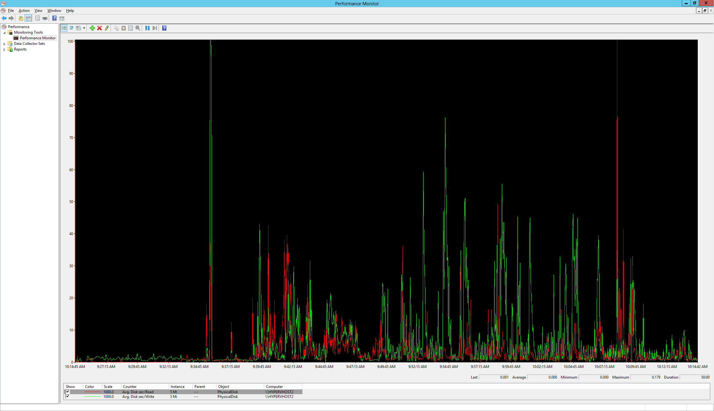

I'm guessing there has to be something wrong with my configuration. Attached are two disk latency perfmon captures of installing a new Server 2012 VM from initial boot, to fully patching up to date from our WSUS server.
First test is read/write latency on local disk:
Local Disk
Local Disk

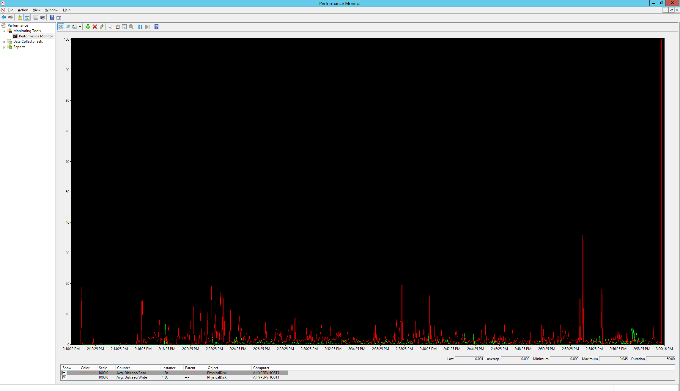

Second test is read/write latency over iSCSI using Starwind on the same array, but from the seond Node:
Through Starwind iSCSI with 10GB Write-back Cache
There has to be something wrong with the way I have Starwind configured, as I can't reconcile the terrible write latency of the SW test with it's 10GB of write-back cache vs uncached 4x1TB 7.2k spindle local disk.
