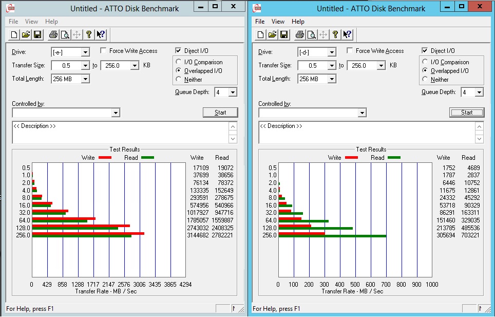

I am having trouble with a cluster. Please see image below.
The test on the left is running from the raw disk. The one on the right is a HA Image.
The cluster is 2 node Windows 2012 (fully patched) with Native SAN 6.0.5587 with the following hardware. Setup per the "Configuring HA Storage for Live Migration on Windows Server 2012" guide.

My money is on a simple config issue but I have yet to put my finger on it.
Any help would be appreciated.

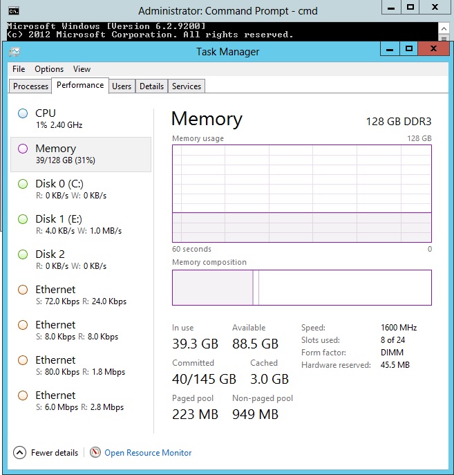

1) I'll ask engineers to make sure you do have it working. What OS build do you have? Can you report what cmd says when run?
2) How much memory does the whole system has? Free? Can you provide a Task Manager screeenshot?

Build 6.2.9200
Server 1
Server 1.jpg (123.25 KiB) Viewed 19488 times

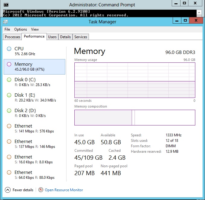

Server 2
These servers have 128GB and 96GB respectivly. The cluster is not fully loaded yet, I still have my heavy load VMs running on stand alone until I can resolve this performance issue.
