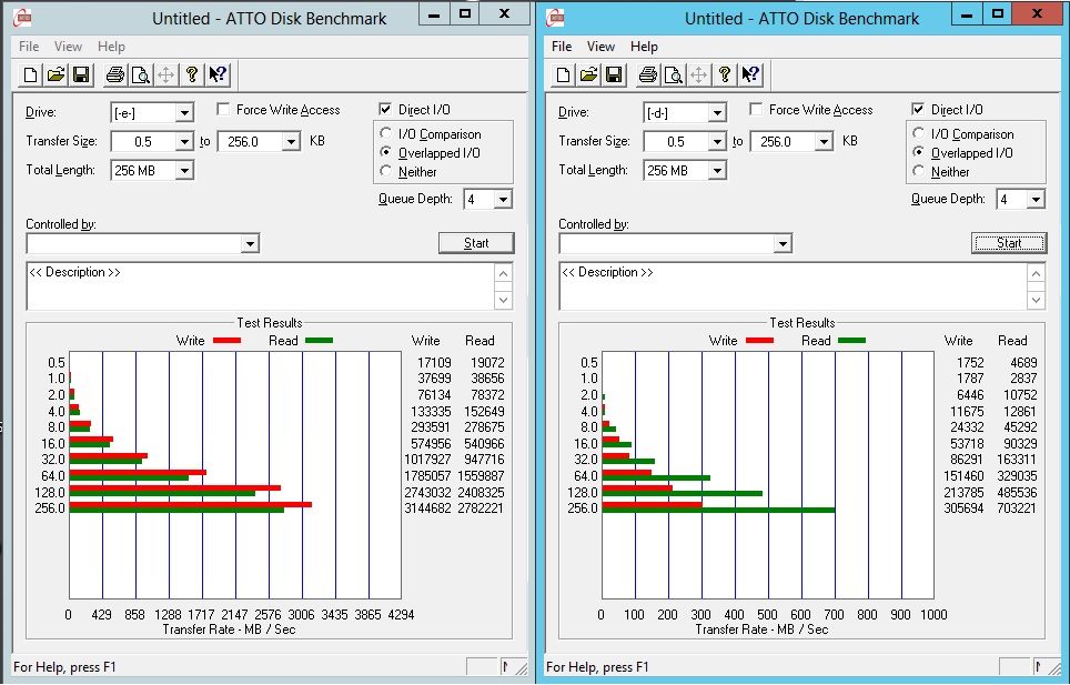

I am having trouble with a cluster. Please see image below.
The test on the left is running from the raw disk. The one on the right is a HA Image.
The cluster is 2 node Windows 2012 (fully patched) with Native SAN 6.0.5587 with the following hardware. Setup per the "Configuring HA Storage for Live Migration on Windows Server 2012" guide.
Network
iSCSI - 10Gb Direct Connect with Intel x540's on both Sides
Sync - 10Gb Direct Connect with Intel x540's on both Sides
Heartbeat - 1Gb Direct Connect with Intel I350 to Broadcom BCM5709C
Management - 1Gb nic to Core Switch on each node
Hyper-V - Nic Team with 2x BCM5709C to Core Switch on each node
Disk
12 disk 1 TB SAS Raid 0
My money is on a simple config issue but I have yet to put my finger on it.
Any help would be appreciated.

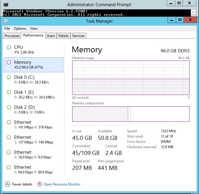

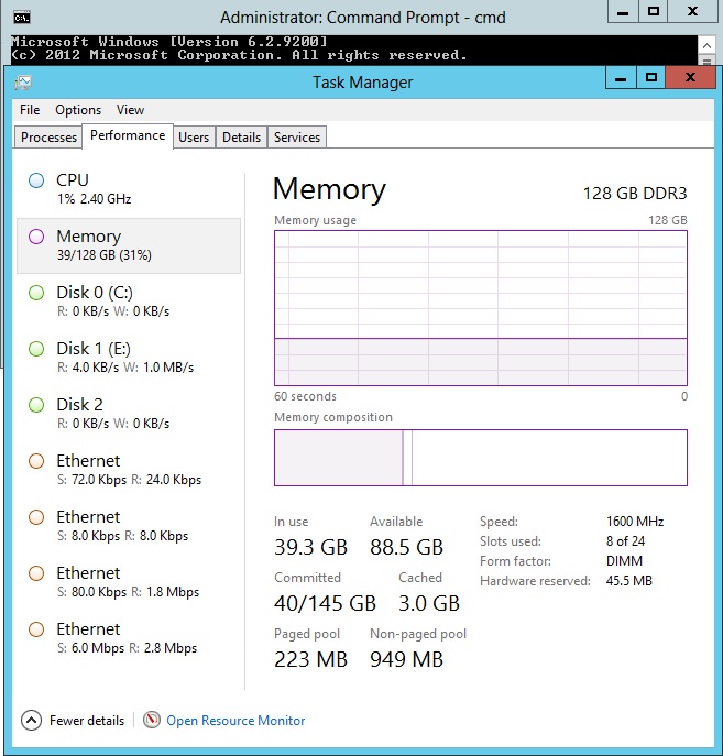

1) I'll ask engineers to make sure you do have it working. What OS build do you have? Can you report what cmd says when run?
2) How much memory does the whole system has? Free? Can you provide a Task Manager screeenshot?

btoups2
Posts: 6
Joined: Wed Apr 10, 2013 1:59 am
Fri Jul 19, 2013 1:31 pm
Build 6.2.9200
Server 1
Server 1.jpg (123.25 KiB) Viewed 19482 times
Server 2
These servers have 128GB and 96GB respectivly. The cluster is not fully loaded yet, I still have my heavy load VMs running on stand alone until I can resolve this performance issue.
