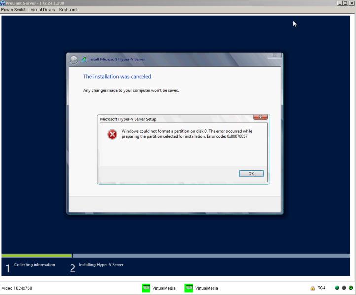

Symptoms:
Hyper-V Server 2012 boots and begins install
I provide the Emulex device driver to support iSCSI boot volumes
Drive list refreshes and displays Drive 0
I select the Drive 0 for install and it proceeds
The drive is successfully partitioned
Then it attempts to format the drive and fails
Final Error Message:
Microsoft Hyper-V Server Setup
Windows could not format a partition on disk 0. The error occurred while
preparing the partition selected for installation. Error code 0x80070057
If I boot into repair mode and attempt the same process with 'diskpart'
clean - succeeds
partition - succeeds
format fs=ntfs quick - fails
diskpart > 'list disk' indicates there are no disks available

Attached: I noticed in other similar cases people have been asked to increase the logging verbosity level and upload a copy of the starwind log. I increased it from level 1 to level 2 and have attached it after trying to format the partition again.
A Screen Capture of the Hyper-V Server 2012 Install failure due to failure to format the iSCSI Bootable LUN 0

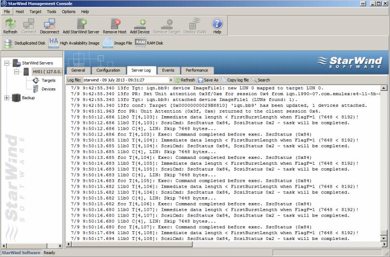

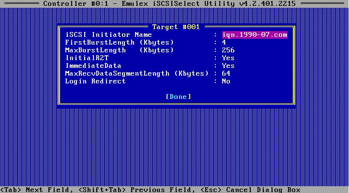

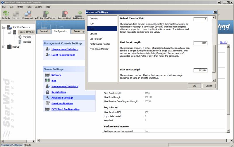

Had an awesome meeting with Mac Craft this morning.
He identified an issue with the HP NC553i 10 Gb Dual Port Lan on Motherboard Adapter in the BL490c Gen 7 blade server we are using.
It has Emulex iSCSISelect Firmware version v4.2.401.2215 currently installed.
Max was more precise, but I believe the issue was with the "FirstBurstLength" parameter of the iSCSI Initiator configuration.
The parameter is set per Target, but in the Emulex iSCSISelect Firmware it is was fixed and not modifiable at 4 Kilobytes.
The Starwind log reported the "FirstBurstLength" used by the Adapter appeared to be less than that negotiated and dropped the traffic.
After Max modified the "FirstBurstLength" in the Starwind Server -> Configuration (tab) -> Server Settings -> Advanced Settings -> Modify (hyperlink) -> PopUp -> SCSI (nav) -> "First Burst Length" (textbox) -> from 65536 to 4096
And then restarted the Starwind service (in order to force the Adapter to relogin and renegotiate the connection) the Hyper-V Server 2012 then could partition and a complete restart of the Installation succeeded normally.
Max indicated this might be such a low number it could effect performance and that I might want to take it up with the Firmware provider to see if there is a way of configuring the parameter on the Adapter to a higher value.
