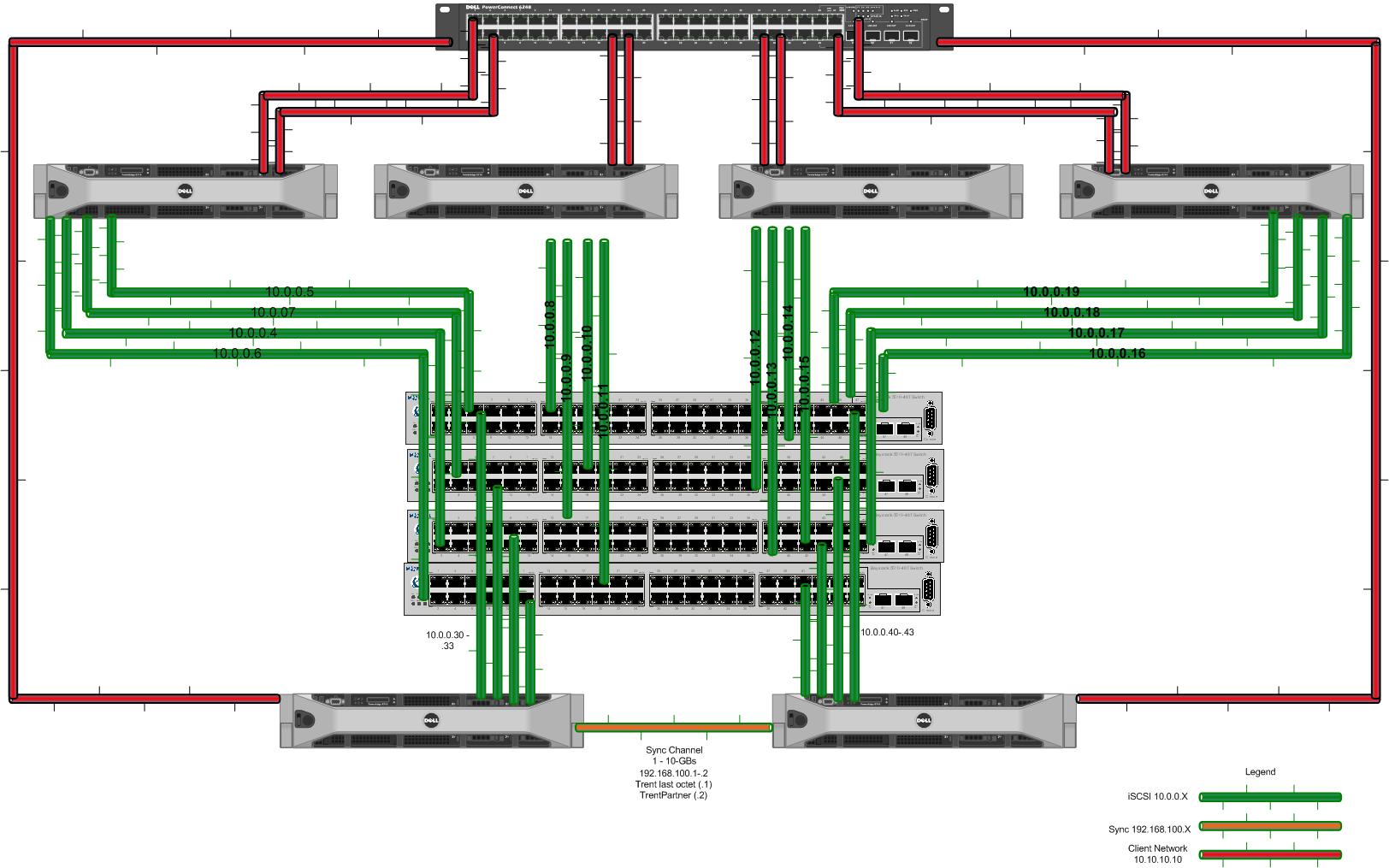

I have actually posted here in the past with similar problems that I eventually discovered the issue. I have the VMware servers and SAN configured per the best practices guides, using Jumbo Frames, iops 1, round robin.
In the network diagram, I only have 2 paths from each ESXI host going to the SAN's. IE from one my hosts, i only have added to the dynamic discovery 10.0.0.32, 33 10.0.0.41,.43 or else I would overload the SANs.
It's odd to me that I can achieve such fast speeds from the older Windows 2003 server and such slow speeds from the newer Windows 2008 x64 VM when they are hitting the same SAN, from the same host.
Network scheme
Network scheme
Hellam ESXi Topology.jpg (200.25 KiB) Viewed 40820 times

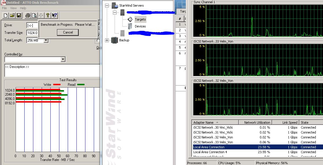

Just an update - i've tried a couple of things with no luck.
Manually changed the SCSI controller of the Windows 2008 VM from LSI Logic Parallel to LSI Logic SAS (also tried using VMware Stand Alone converter to change it)
Moving the VM to a new host, and a different SAN

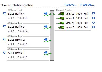

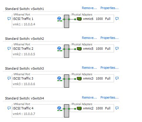

Moving the VM to a host that is running ESXi 5.0, build 469512 and testing it on ESXi, build 914586. Each host has a different network configuration due to a known issue when a link goes down and comes back online. (see attached)
Ensured both RoundRobin, IOPS=1, and jumbo frames are enabled (which is proven by my 2003 VM running so quickly) - have a lengthy forum post already here with what I went thru to achieve optimal settings http://www.starwindsoftware.com/forums/ ... t2910.html

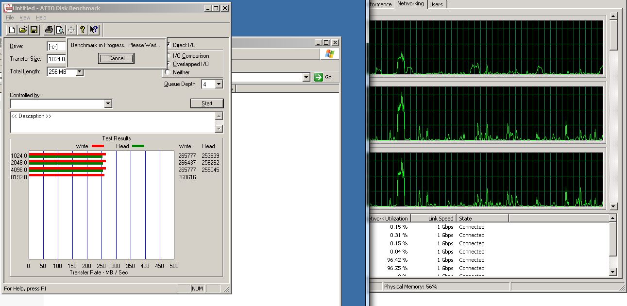

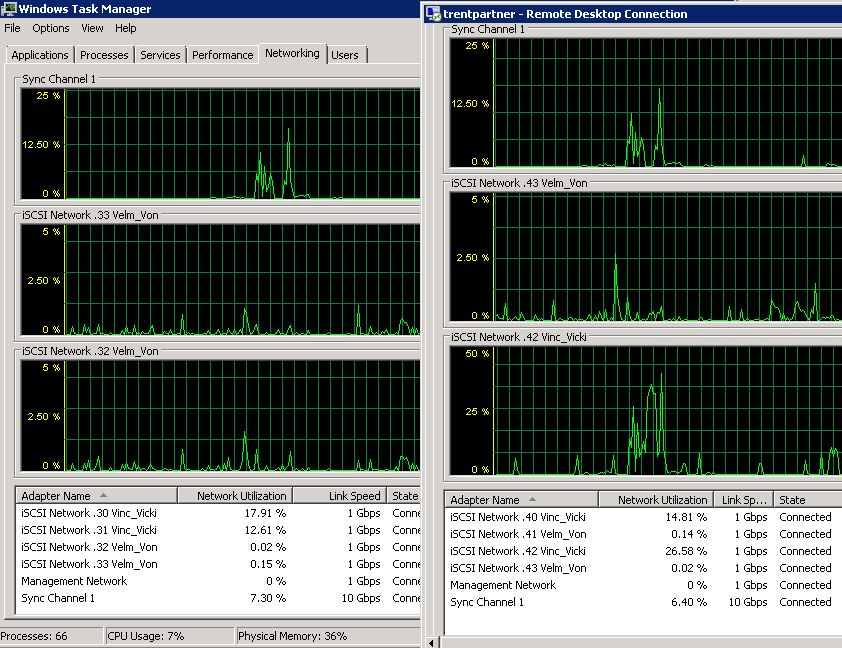

I can't attach more than 3 pictures, or anything larger than 256KB (what's that about, it's 2013!) so i'll just add the screenshot of my SAN's network utilization when running an ATTO from the Winodws 2008 VM - it's utilizing less than 1/4 of each NIC it's programmed for. However, when I do the ATTO benchmark from a Windows 2003 VM on the same host - accessing the same SANs - over the same NICs, those utilization numbers are between 95% and 99% when I run the ATTO benchmark utility.
I only have one ESXi host running on that old build for 5.0 because it's running our ERP system locally - and I haven't been able to schedule downtime just yet to stage the patches and remediate.
I am currently building a new ESXi host, on newer hardware, and will try it from there (fully patched) to see if the outcome is any different. I have to order some hardware for it to get the gigabit pathways to the SAN to test, so it may be a little while until I can post what happened.
Windows 2008 VM SAN iSCSI network utilization
SAN netutiliz win2008 vm.JPG (158.87 KiB) Viewed 40730 times
VMware 4695152 network config
build 4695152 iscsi network.JPG (40.62 KiB) Viewed 40715 times
VMware 914586 network config
build 914586 iscsi network.JPG (28.47 KiB) Viewed 40713 times

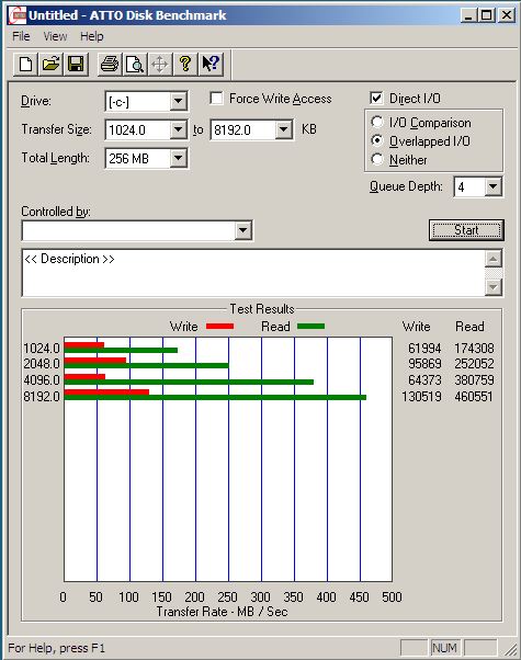

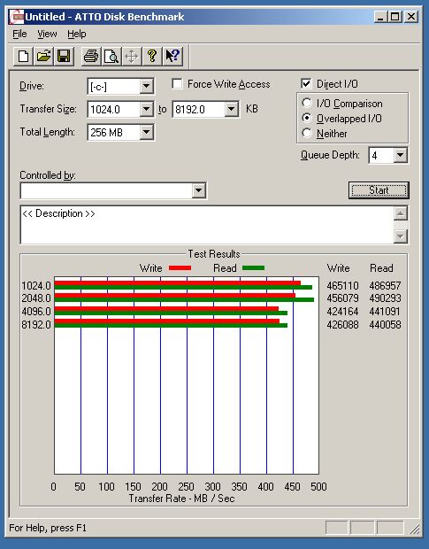

Attached are examples, one is a 2003 VM, the other is a 2008 VM. Both on the same host, same SAN. I have tried changing hosts, and SAN's, with no luck.
I have 7 Windows 2008/2008 R2 VM's and all of them behave the same
VMware has dismissed it as being an issue with ESXi and told me to contact my SAN vendor.
2008 VM.JPG (61.76 KiB) Viewed 40589 times
2003 VM.JPG (65.41 KiB) Viewed 40588 times
