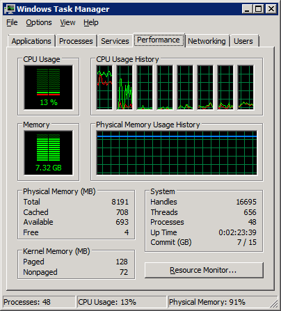

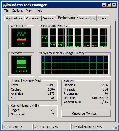

thanks for the reply, i was asking because with a Dedup virtual drive we can reach a max performance of 40 MBytes / Sec, with 80% allocated ram on the Starwind server, and just 1 core using 15% CPU.
The other CPUs are 0 % used, so it's clearly using a Single core for the dedup process.
I can give you another information. In the task Manager i can read the the Dedup process is using 20 Threads.
How can i fix this?
Thank you very much

I allegate 2 screenshots showing the situation

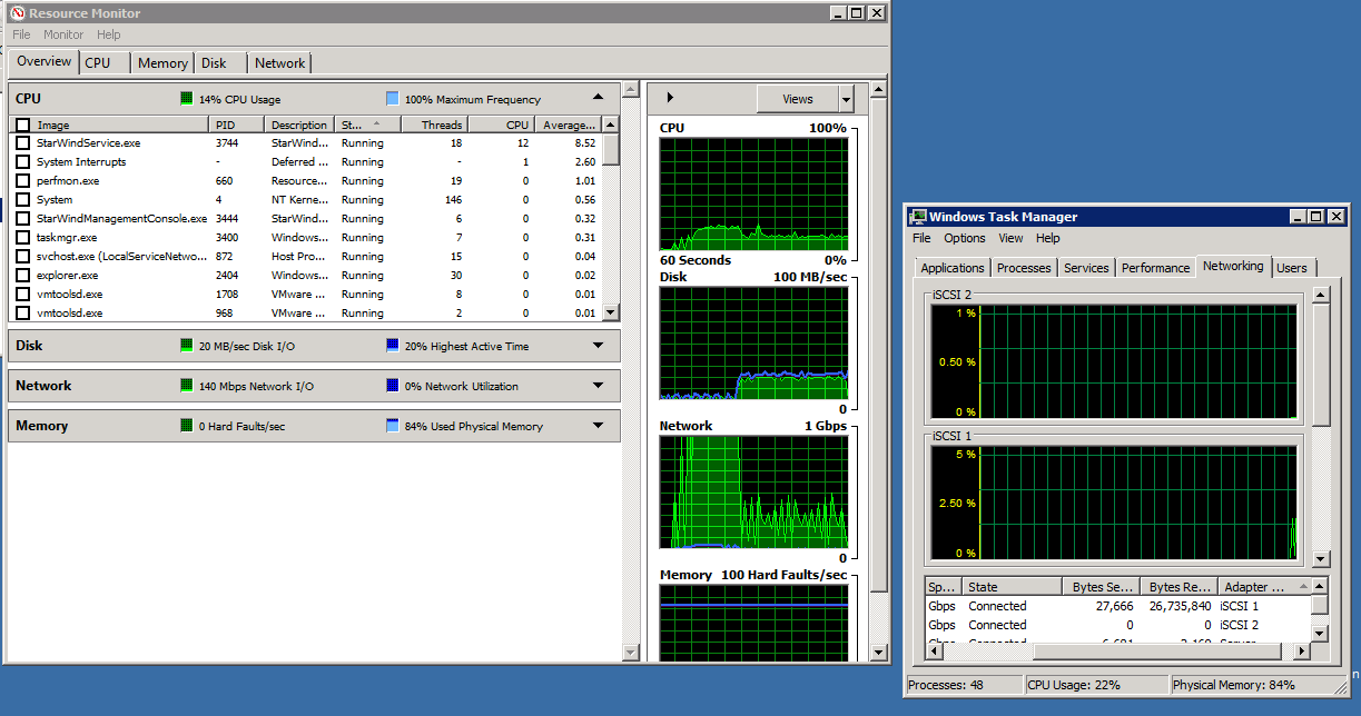

I tried to add a second Dedup Virtual Drive and copying 3 files concurrently on the 2 drives.
The situation doesn't change and the overral throughput from the Client to to the iSCSI target remains of 30 Meg / Sec with a CPU % of 12 on the Starwind server

CPU is not limiting factor with StarWind dedupe: disk subsystem is. So giving more cores / GHz is not going to improve anything as
hash caclulations on critical path is maybe 5% of time (maybe less). Throwing more spindles / going flash DOES help to boost performance because
of storing metadata stealing IOPS.
Vitaly would be able to tell more tomorrow.
Vitalii (staff)
Posts: 44
Thu Apr 25, 2013 12:06 pm
That version does not support multi-threading.
But, the deduplication library supports using multiple threads. It will be available in the next major release.

We were aware of the storage requirements so we put the Dedup repository on a 15k FC San.
Moreover, as you can see from the graph, disk occupation is far below a single SATA disk bandwidth.
@Vitalii
Thanks for the reply. So we'll wait for the next major version in order to retest the Dedup again with Multi core support.
