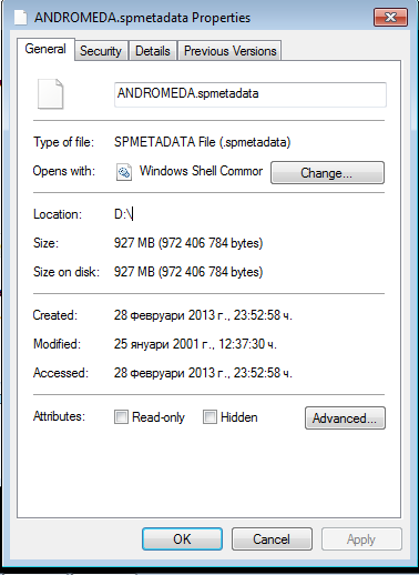

Can you provide us the StarWind version that you are currently running and the screenshot that illustrates that ANDROMEDA.spmetadata file is presented on the disk?

Here is the screenshot and the StarWind version is 6.0.5275. Are there any tools for reading the plain spdata file in case we can't fix it at least to recover the data?
andromeda spmetadata properties.png (20.24 KiB) Viewed 12426 times
