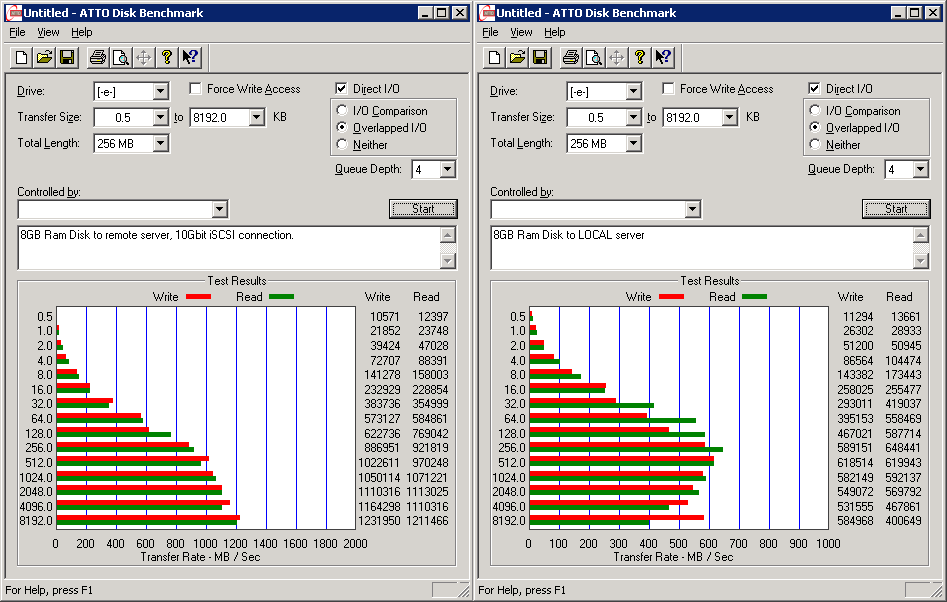

So I've been having issues with Starwind performance being, well pretty bad and I have stumbled across an interesting discovery.
fyi Product is Native San for Hyper-V, 2 nodes, both severs are dell pe720 with 192GB ram, 6 disk 840 Samsung Pro in Raid 10, 10gbit connection for sync, separate 10gb for iscsi.
What I found was that if I created a ramdisk on server A, and connected to it via the MS iSCSI iniator, and ran ATTO benchmark (or any other benchmark for that matter) performance was lower than a local mechanical hard disk! BUT!!!! If I connected the same ram disk to Server B over the 10gbit link, the performance was MUCH higher. Please see the attached photo.
So my dilemma is....how do I fix this? I do not want to have to spin up 2 additional servers just for storage, that was the whole point of using the "Native" SAN for Hyper-V.
What a difference!  Local should be faster, right?  But it isn't.....something is off!

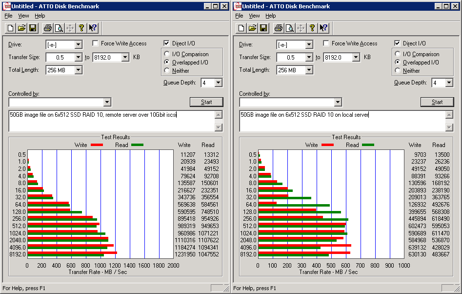

Just as an additional note- same performance issues with the SSD array-

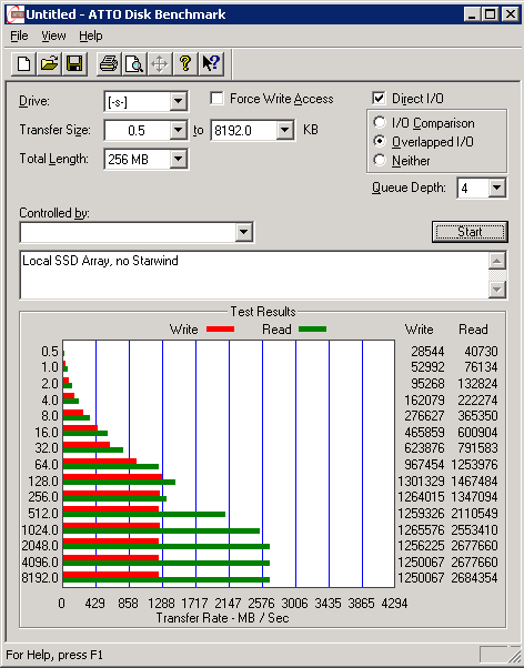

And here is the SSD array without using Starwind. Quite a bit of difference.
Sun Mar 17, 2013 9:13 pm
TCP loopback within Windows is SLOW. We've applied special optimization technique to boost loopback performance dramatically. This will be included with the upcoming version. If you'd like to test it now (it's a stand-alone component so no need to change anything) we can "leak" you premature version.
