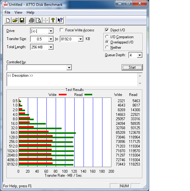

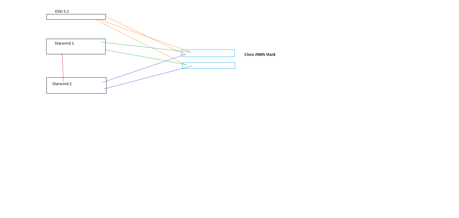

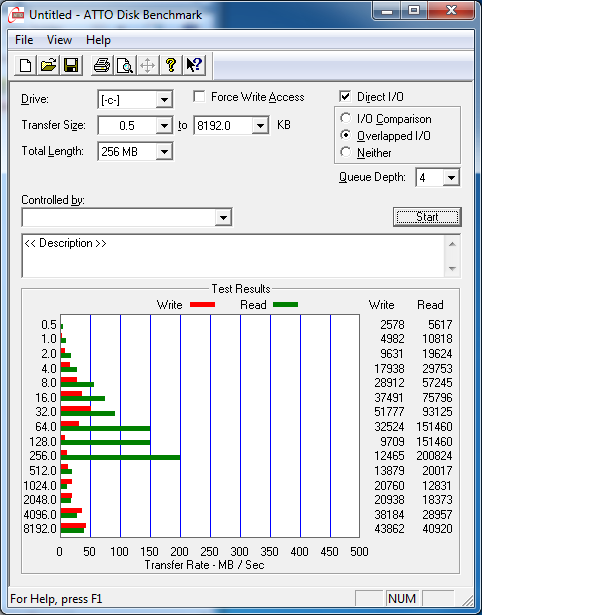

I am in need of help, and not sure what to do at this point. I have been banging my head against the wall all day with performance issues. Right now I have 2 nodes in HA on Starwind. Each with 4 x 1GB NICS. 1 is for management, 1 is for sync, and 2 are the addresses actually being used for the iSCSI. I currently have Write Back caching turned on in the iSCSI target and jumbo frames all the way through. The physical layout looks like:
If I use fixed path path management I get basically wire speeds for gigabit as seen below.

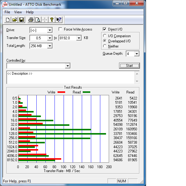

But if I use MPIO and set iops = 1 I get:
As you can see some multi pathing is happening as I do manage to get a speed of 200MB/s once, but it's just all over the place and I don't know why.

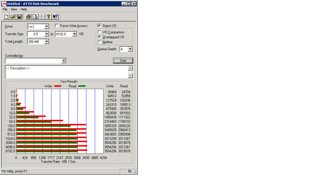

The forums will only allow me to attach 3 screenshots, but the benchmark on the physical servers is coming in around 3.4GB/s so certainly not the bottle neck there.

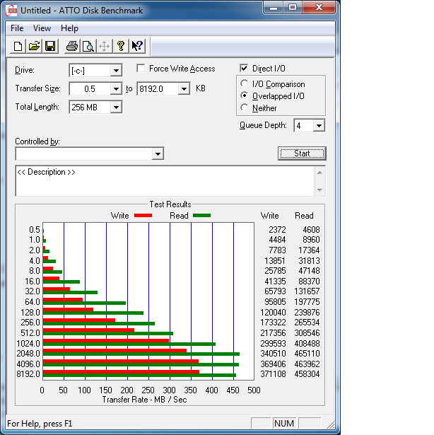

A few more notes. First, just in case there is doubt, below is the performance when ran right on the starwind server:
I'm starting to think the issue might be Jumbo Frames. I returned the MTU in ESX to 1500 and disabled jumbo frames on the Starwind server. They are still enabled on the switch as that requires a reload which I'm not willing to do now, but the switch should just forward the smaller frames right along. Anyways, the performance with Jumbo Frames off is somewhat better but still not stellar.

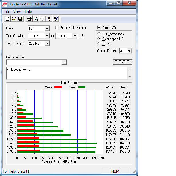

I believe I finally figured it out but thought I would document it here for others that could use the help. I had been using 1 /27 subnet for all network adapters in the toplogy. I noticed when I went to look at the multipath options that it was detecting something like 72 paths to one target which seemed weird. I went back and gave each NIC on the ESX server it's own VLAN and /29 Subnet. I then put matched up the NICS from each node(remember, 2 NICS per Starwind Host for a total of 4) with a 1:1 relationship with the ESX server. After retesting I'm now seeing:
The writes aren't fantastic, but I figure that's probably either part of the RAID50 penalty, or maybe the writes don't multipath the same way the reads do. Regardless, much better now.

Now we're where I want to be. One of the support techs mentioned something in an email about sync channels and that clicked my brain why my writes were so much slower than my reads. I added more sync channels and now you will see exactly what you would expect from a 4 x NIC RAID 50 solution.
