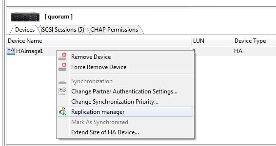

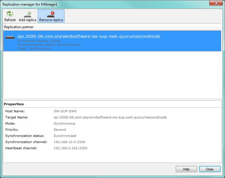

That's really easy with HA - right click on the HA device that will remain online, select replication manager.
Remove the replica
Now go to the node you'll be turning off and delete the HA target you just excluded in the replication manager. Stop the StarWind service. Now you can do all the necessary actions with the disks.

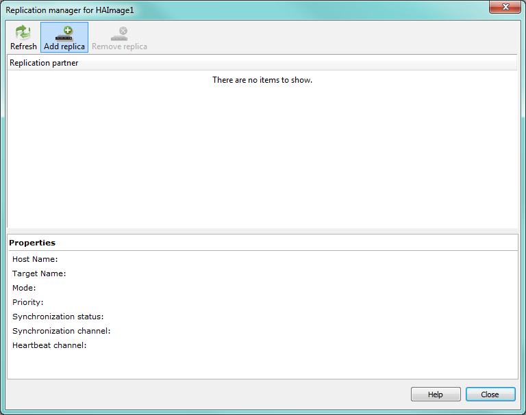

When the server is back online - do the necessary initialize-format-assign letter staff. Now check if StarWind service has already started. Go back to the replication manager and press the "add replica" button.

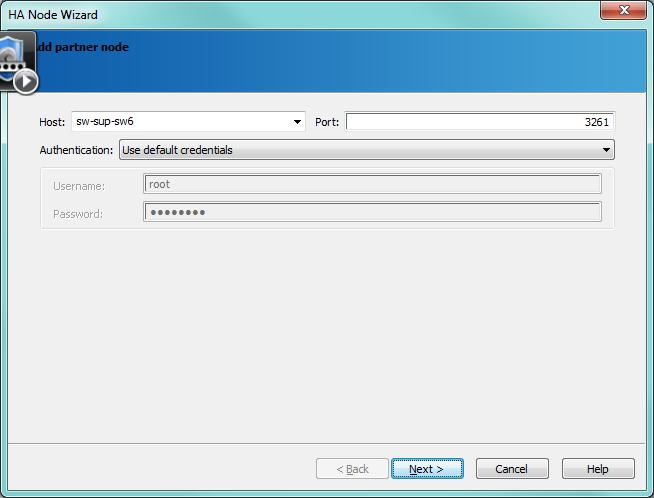

Point the wizard to the partner server

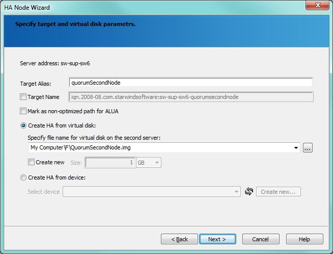

Choose the image file(if left) or enable the "create new" checkbox

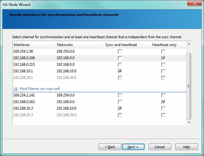

Select the sync and heartbeat channels.

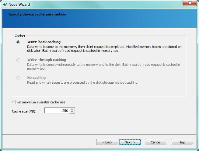

Select the previously defined cache size for the HA device. Do not increase or shrink the cache!
