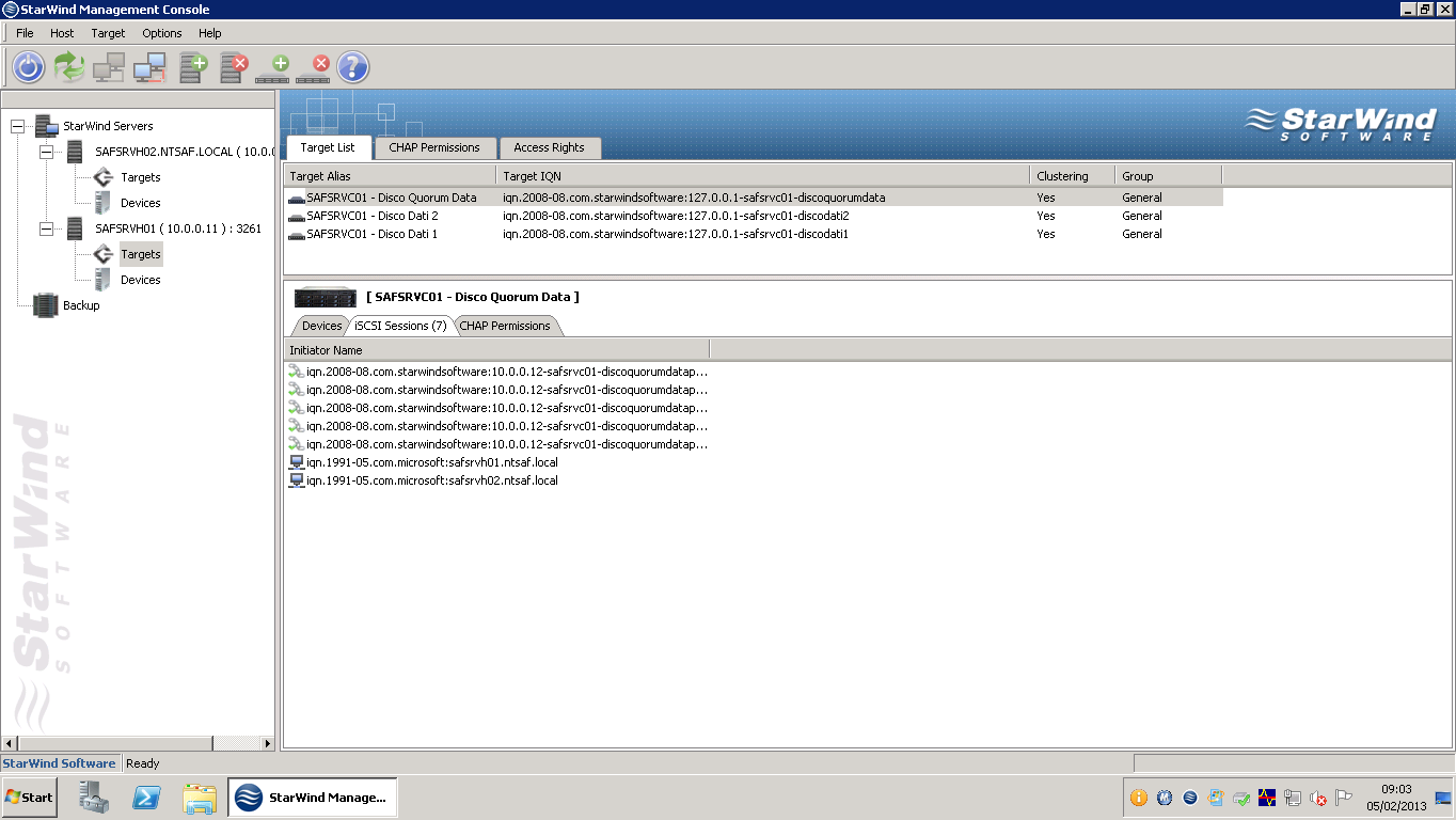

1. Not sure exactly, but can you post pictures of the isci Initiator Properties the targets tabs on both Hyper-V machines in the cluster.

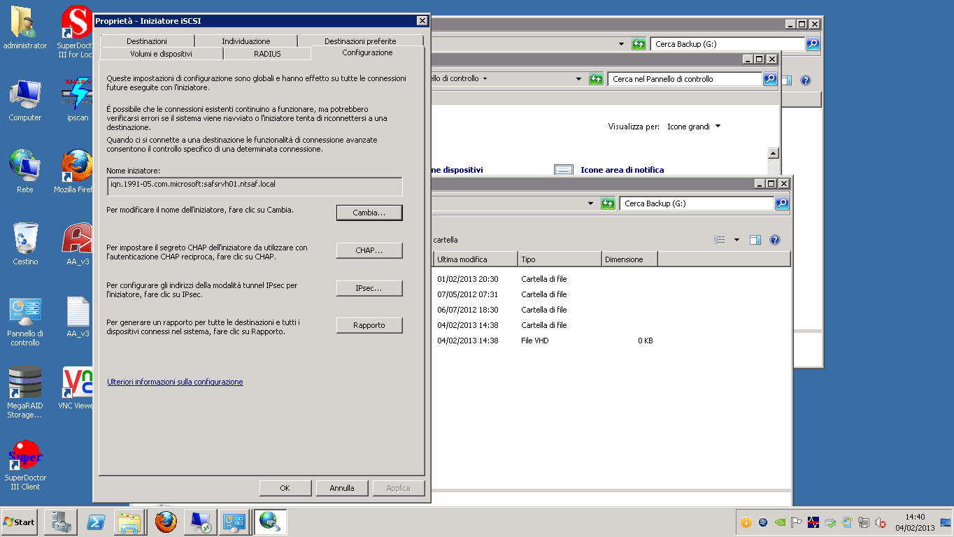

lonewolf74
- Posts: 12
- Joined: Thu Jan 31, 2013 8:03 am
Tue Feb 05, 2013 9:14 am
Add Photo form ISCSI Microsoft and ISCSI of Starwind.
in the follow message i attach this image
- ISCSI - Configurazione - SERVER 01.png (92.5 KiB) Viewed 23600 times

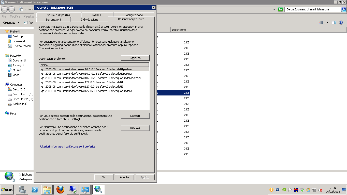

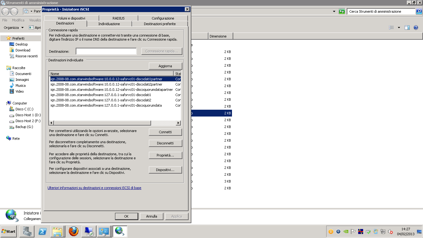

lonewolf74
- Posts: 12
Tue Feb 05, 2013 9:15 am
second image - ISCI Targets
- ISCSI - DESTINATANAZIONI PREDEFINITE - SERVER 01.png (71.38 KiB) Viewed 23600 times

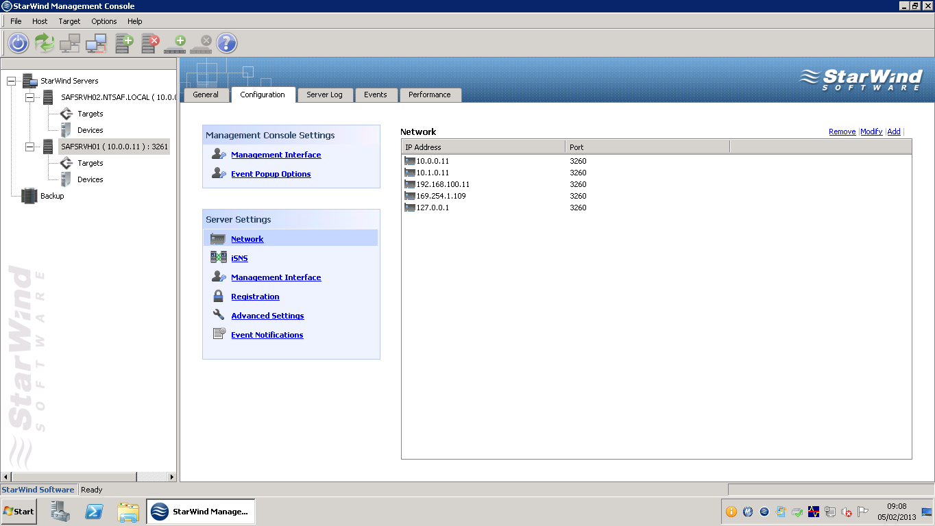

lonewolf74
- Posts: 12
Tue Feb 05, 2013 9:21 am
I also see many IP address in Starwind incorrect, i must delete or wath can i do?
Is Correct?
I only use 192.168.100.x, 10.0.0.x, 10.1.0.x

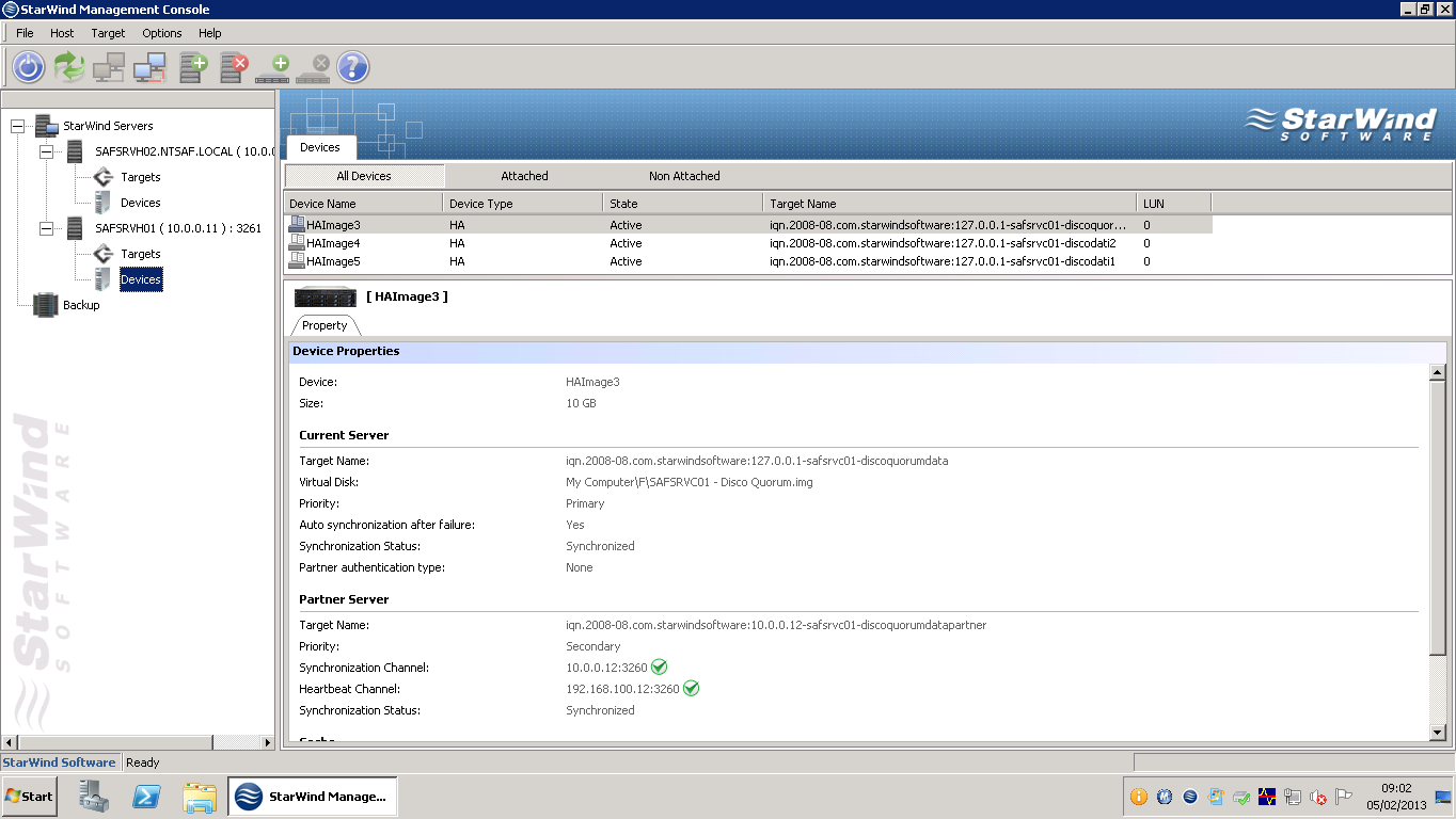

Attach Server 1 starwind LAN config image
- Starwind - Server1 Network.png (76.28 KiB) Viewed 23593 times

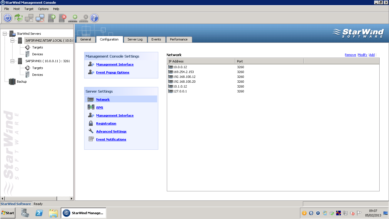

lonewolf74
- Posts: 12
Tue Feb 05, 2013 9:23 am
Attach Server 2 starwind LAN config image
- Starwind - Server2 Network.png (75.82 KiB) Viewed 23596 times

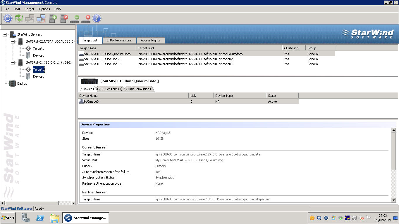

Max (staff)
- Staff
- Posts: 533
- Joined: Tue Apr 20, 2010 9:03 am
Wed Feb 06, 2013 1:09 pm
Hi Lonewolf74,
Seems like the HA devices are connected properly.
The networks you see in the StarWind management console are those StarWind has discovered as usable.
You can restrict use of certain networks by disabling them.
As for the VHD issue, I would agree with Jeddyatcc - it can get a little complicated on the CSV.
Does the export option work for you if you do it via cluster manager?
Max Kolomyeytsev
StarWind Software
jeddyatcc
- Posts: 49
- Joined: Wed Apr 25, 2012 11:52 pm
Thu Feb 07, 2013 12:50 pm
Thank you very much for the pictures. On the Destinazioni tab can you scroll over to show the Status, and I would need to see that for All Hyper-V hosts in the cluster.
