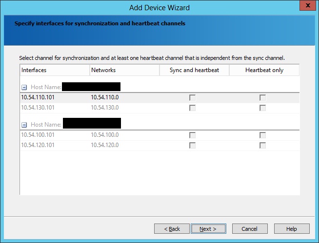

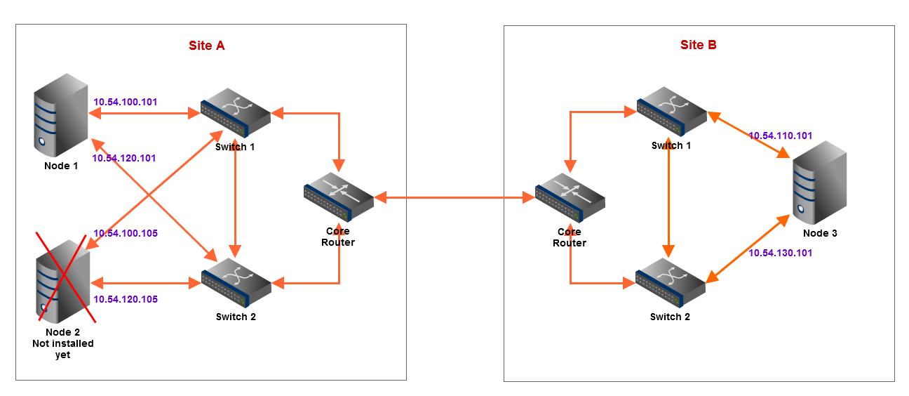

I'm in testing phase for multisite (1Gbps link) Windows 2012 Cluster. I have a problem connecting them due different subnets.
To simplify it, my network looks like this:
Site A DC: 10.54.100.0/24 & 10.54.120.0/24
1gbps vpn tun
Site B DRC: 10.54.110.0/24 & 10.54.130.0/24
As you figured out, i'm not able to pass the network validation step for HA, where it is required to have 2 x identical subnets each site (which cant be accomplished in my case).

I would recommend that you stretch the subnet for the Sync Channel. I know that this can pose some problems, but if you can meet the latency requirements that is probably the only way to make it work. If you are using the 3 node setup, I think you can use different subnets (haven't tested, but that "should" be the way it works) for the 3rd replica node.

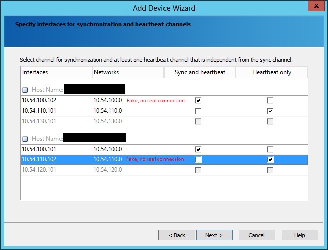

jeddyatcc wrote:I would recommend that you stretch the subnet for the Sync Channel. I know that this can pose some problems, but if you can meet the latency requirements that is probably the only way to make it work. If you are using the 3 node setup, I think you can use different subnets (haven't tested, but that "should" be the way it works) for the 3rd replica node.
Thanks for reply. Unfortunately it's not a restriction by latency or stretched subnet, but due simply fact that starwind validates the network only by a simple match (plain text if i may say so). I did a dumb test by adding to each node a secondary ip (from the other side) to one of the eth and now it looks like starwind recommended config:
Site A DC (Host 1): eth1 - 10.54.100.101 (real), eth2 - 10.54.120.101 (real), 10.54.110.102 (no access to site B where this subnet is used)
1gbps vpn tun
Site B DRC (Host 2): eth1 - 10.54.110.101 (real), eth2 - 10.54.130.101 (real), 10.54.100.102 (no access to site A)
Really need to figure this out! I would appreciate any help.
