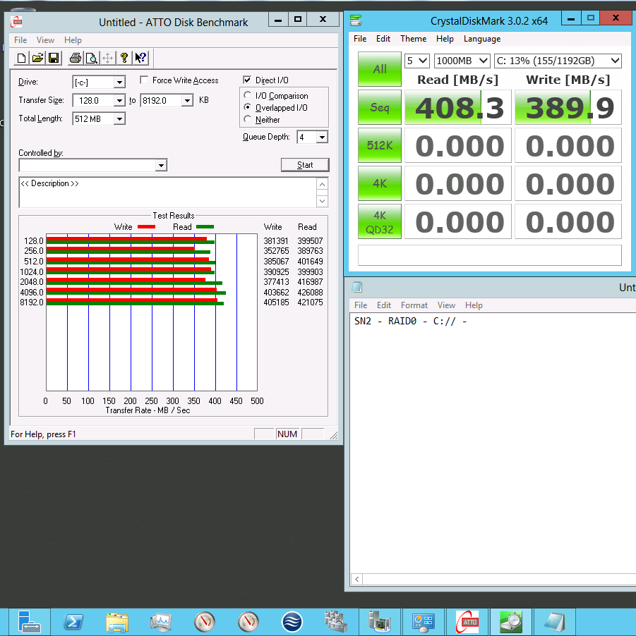

StorageNode2 - raid0 - Subsystem Bench

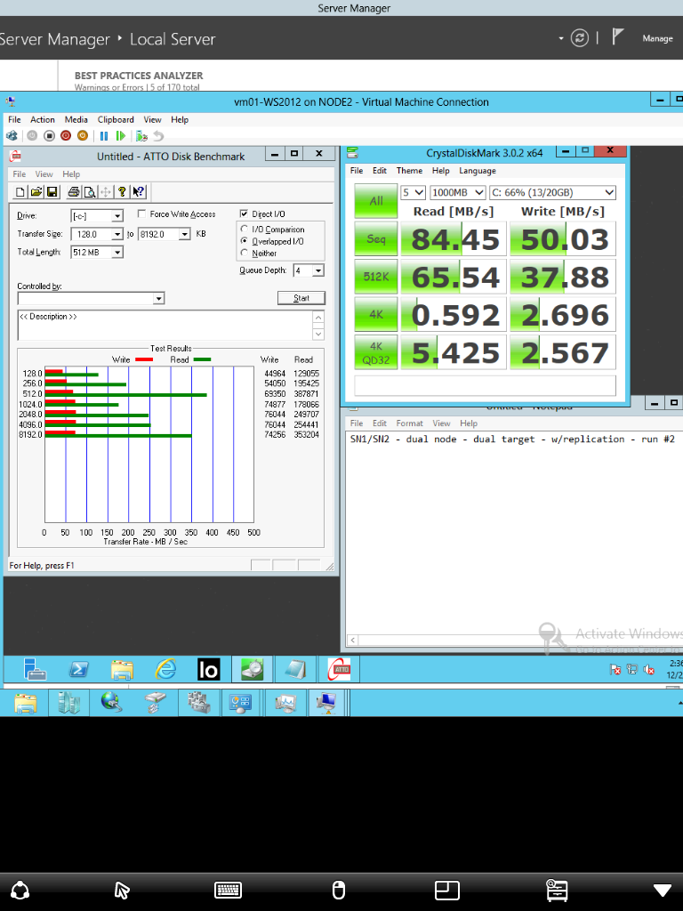

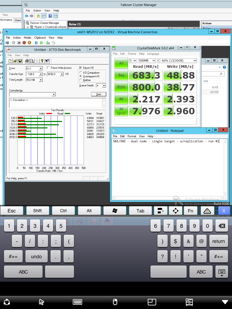

StorageNode1/StorageNode2 - HA targets w/sync - 4 way multipath(2 nics per node)
StorageNode1/StorageNode2 - HA targets w/sync - 2 way multipath(1 nic per node)

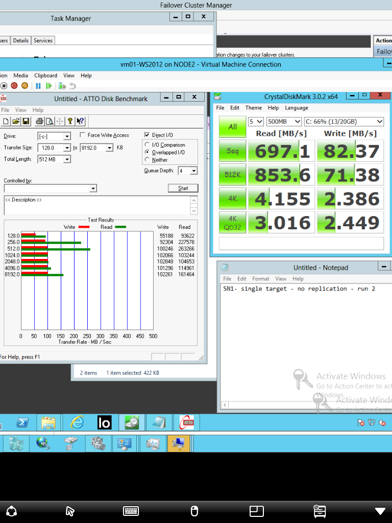

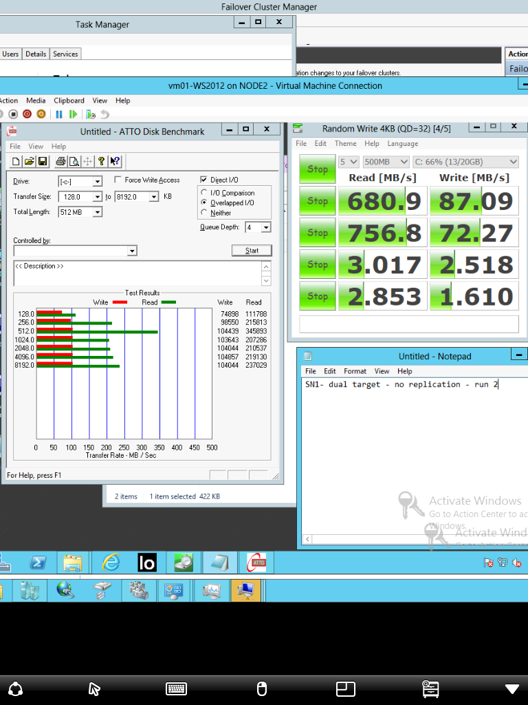

StorageNode1 - Standalone target - no sync - 2 way multipath(2 nics, single node)
StorageNode1 - Standalone target - no sync - 1 way path(1 nic, single node)
